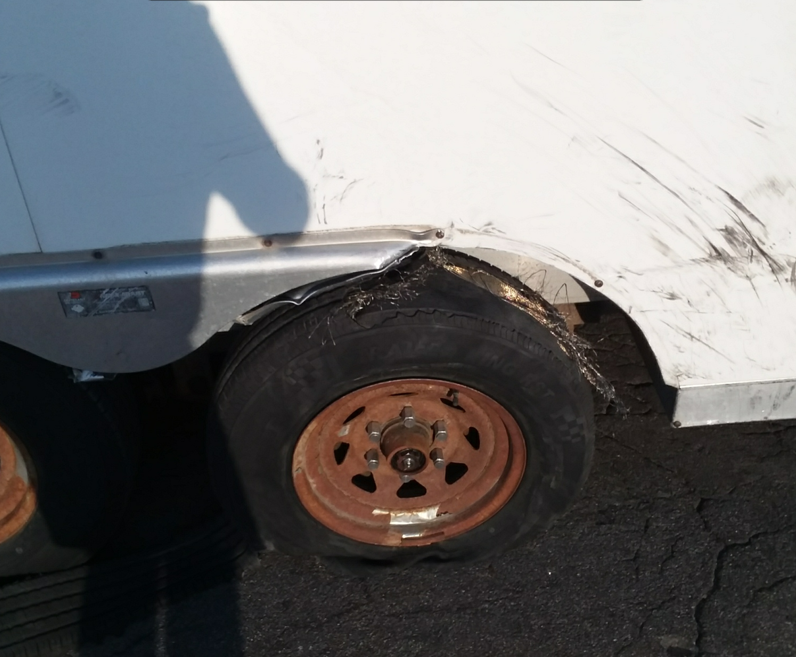

Had a great time at Atco this weekend. Blew a tire on the way home(banged up the trailer!). I searched the forum and did not find discussion on trailer tire monitors. You guys that have been using them for awhile please let me know which ones you like. I would also me interested in a system to monitor RV tires and trailer tires.
Thanks in advance! Ray
I dual purpose this trailer for snowmobiling and the rims are rusty. Yes it is getting new wheels and tires now.
