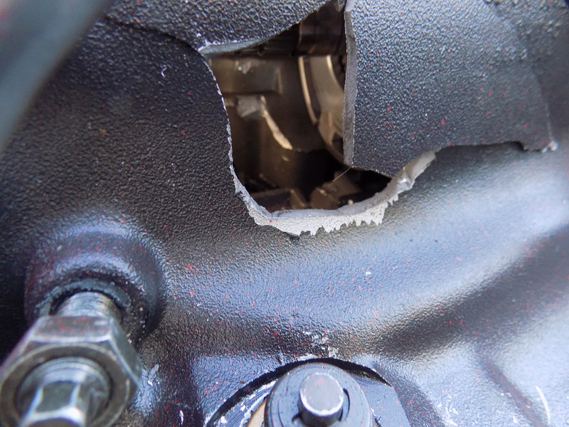

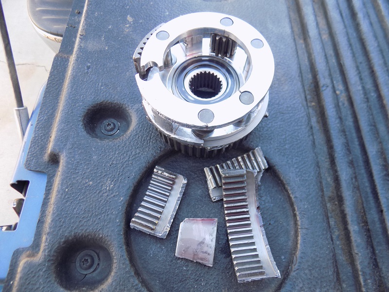

Time seems to be flying by since the finals at Pomona. The down time is short out west here. With a busy schedule (and expensive) coming quick. Pomona followed by Phoenix. Then a double header at Phoenix to start the division 7 year. One of my good friends tested his tranny shield at the last race in Las Vegas at the National race. Shipping and parts take much longer to get right now.
