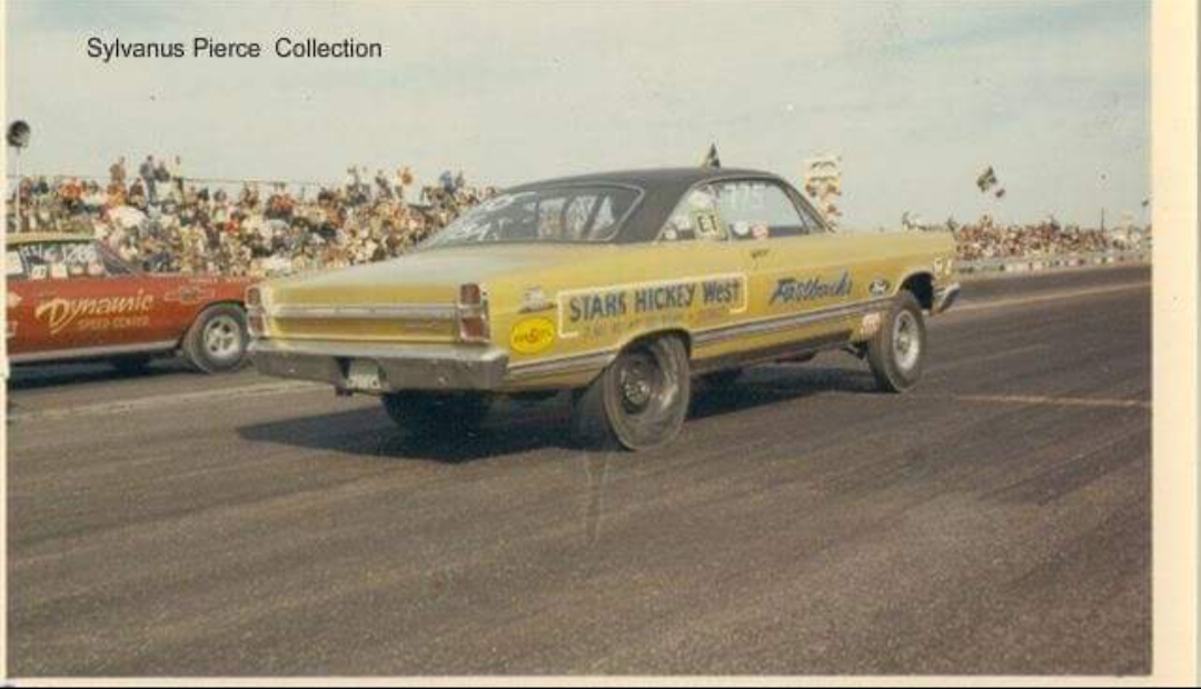

I think the Hinterman car and the Fastbacks Fairlane were the two automatic cars from back in the day. I could be wrong, though.
Mike
