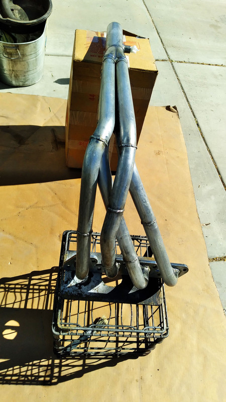

This one is the water pump brackets, and yes , I owe you a finished picture, which I will do soon.
[img]http
s://i.postimg.cc/02gPqLGD/20210515-175323.jpg[/img]
