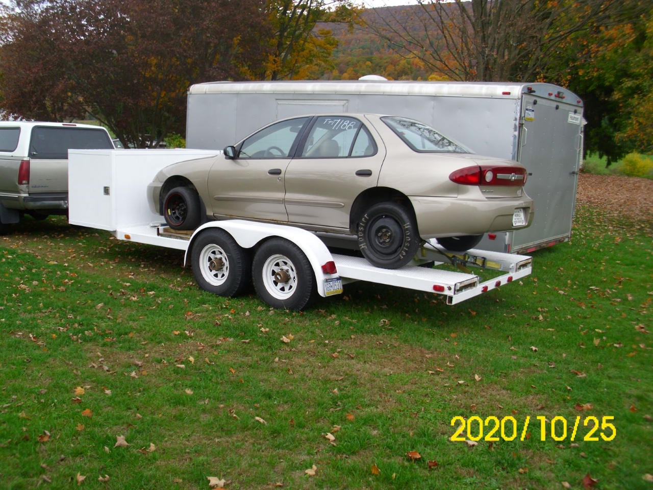

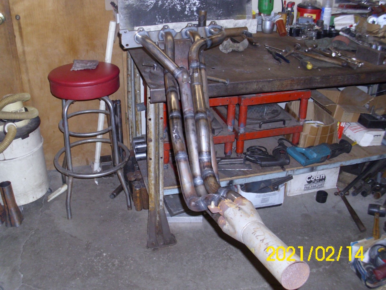

I got an update from Mr. Billy the other day with news that the header is done. He was unable to upload the pictures, so he sent them to me to see if I could get them uploaded, so here they are. Couple miscellaneous pictures of the car in here as well.

Old 02-16-2021, 10:11 PM   #176
Posts: 7,819
Likes: 2,910
Default Re: Not for Nuthin' But Close!
That's not Billy's trailer, is it? ;-)
Old 02-17-2021, 08:14 AM   #177
How long are the primary pipes?
Old 02-17-2021, 08:26 AM   #178
Billy Nees
Location: On a hilltop in Pa.
Posts: 4,499
Likes: 3,601
Liked 7,783 Times in 1,743 Posts
35" and that's not the collector that I'll be using.
Someone vandalized it and took off the patina when he wasn’t looking....
