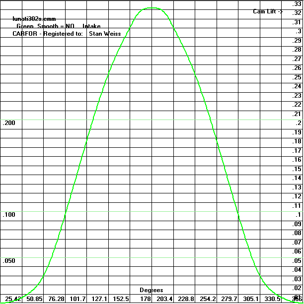

I dug up some old data. This is the lifter raise for a Lunati sticker cam for a 302 Z28 from the mid '70s.Let me add that by the time I got to check the cam it was used.
Stan

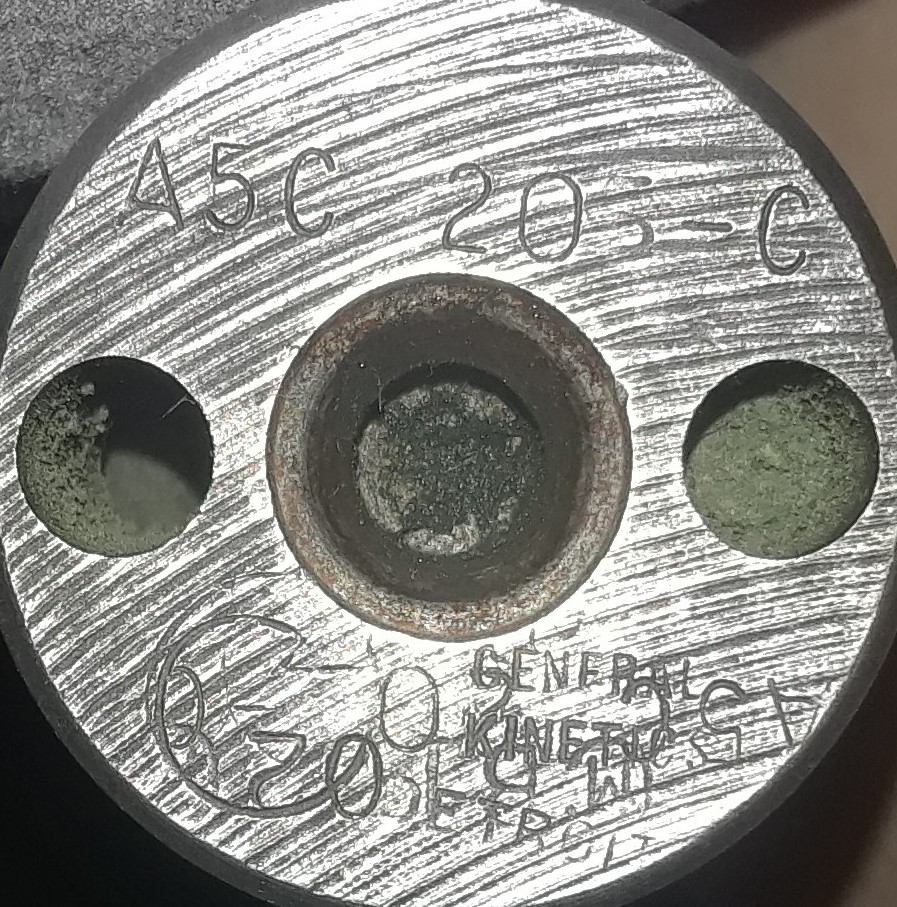

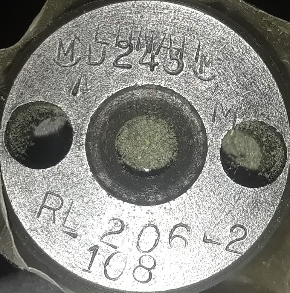

Any of the Mopar 340 guys ever run either of these cams? I think the Lunati is from the 1990s, GK maybe the 1970s?
Name:	GK A5C 205C small.jpg
ID:	56193   Click image for larger version
Name:	Lunati RL-206-2 small.jpg
Mopar 2 Ya!
