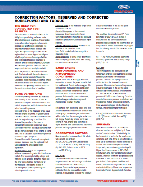

Adger,
Different cars will react differently. Don't know if this will help or not.
Stan

Right Stan.. Combustion chamber design and flame front cause some combos to be good air engines or engines that fall off a lot on bad air days.
In the years of Dyno testing I have also noticed some combinations respond differently as to where the tune up is in the lean rich window.
That is why we test on the track...
