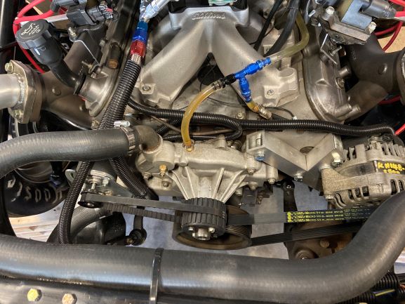

I use the Moroso 63750 water pump drive kit.
Just needed to purchase a longer belt and added one flat washer.
Belt number I used is 240L

Well there is a solution right next door in Alberta. Swansonic do you recall the application for that water pump (car, truck, suv/ year?) Looks way different than the truck one I am working with. Maybe a casting number. Thanks, Bill

I was told it came out of a 2004 pickup, I made the alternator mount and did water pump mod when I had it on my run stand. I have a hard time spending money on things I can mod, I treat it as a challenge.
