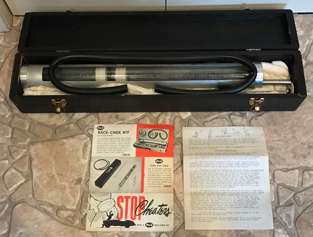

Originally Posted by Ralph A Powell View Post
P&G made one a log time ago! I have 2 kits .
What is a P&G ? We thought that was a tool for checking engine displacement .
ss3011 is offline   Reply With Quote
Old 03-08-2020, 12:43 PM   #25
Posts: 7,819
Likes: 2,910
Default Re: Problem with lash closing up
Valve gapper tool, young fella ;-)
P&G made the valve gapper and the cubic inch tester (pump)...gsa612
