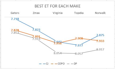

Originally Posted by 340Cuda View Post
I certainly don't have the stats to back my opinion up, but it would appear to me that to anyone that was watching these cars the same day at the same track would think that the Cobra Jets were the fastest, then the COPOs then the Drag Packs.
With these three cars being so different, making them "equal" is no easy task.
I would agree with you 100% at Norwalk. However, the race before that at Topeka a COPO was quickest.
If you look at these best ETs from each race, and remember at the 2nd race and the 3rd race, that the CJ and the COPO were both running pulleys larger than the race prior, yet the DP remained just about as far behind the CJ as it was in the beginning, and much further behind the COPO. Then the last 2 races it is 75lbs lighter and still remains way behind, finishing off farther behind than it was at the beginning of the season, even after all of those rule changes in it's favor.
This makes it seem that rule changes are being made based on current performance, disregarding past performance. What I see is teams running 2 brands that continue to work and make progress, while the other is actually going backwards.
Name:	all brands.jpg
K Danner STK 468

The DP car have the least efficient blowers of the group! No one to blame but themselves.
The older 2.9 Whipple is a heat pump in comparison to the Whipple on the Cobra Jet cars, their 3.0L duel inter cooler is much better. The COPO are much smaller at 2.65L but it’s a roots style. (More efficient air pump)
I seriously think they should all have run the same blowers like it was at the start of the class. Then adjust pulley size and weight to make the parity truly work. If they would have just made pulley changes last year like this year it would have been a way different game.
