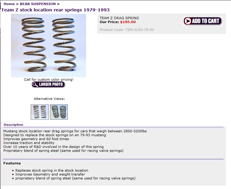

Has anyone tried these ?
Name:	Screenshot_2019-05-23 Team Z stock location rear springs 1979-1993.png
