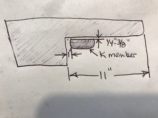

Default Re: Oil pan for 3rd gen f body SBC
I made a sketch of the pan and K-member clearances. From front of pan to sump is 11". Distance between front of sump and K-member is 1". Distance between bottom of pan, non-sump area, is 1/4"-3/8". Not sure if the sketch will attach.
Thanks for the sketch! I see it's pretty tight between the pan and K member, are you using solid motor mounts?. I'm debating notching the K member when I have the motor out.
Again thanks for measuring and have a Happy New Year!
Solid Moroso motor mounts and stock K-member.
