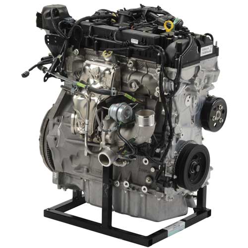

I think you will find that this engine does not have a damper of any kind on it.

Default Re: 2015 Mustang Ecoboost K/SA?
I believe that it has a balancer on it. The picture on the Ford Performance website looks like a balancer.
https://performanceparts.ford.com/part/M-6007-23T
Roland
I know the old 2.3 Turbo Ford ( Pinto based engine) does not use a damper. Not sure about the EB
