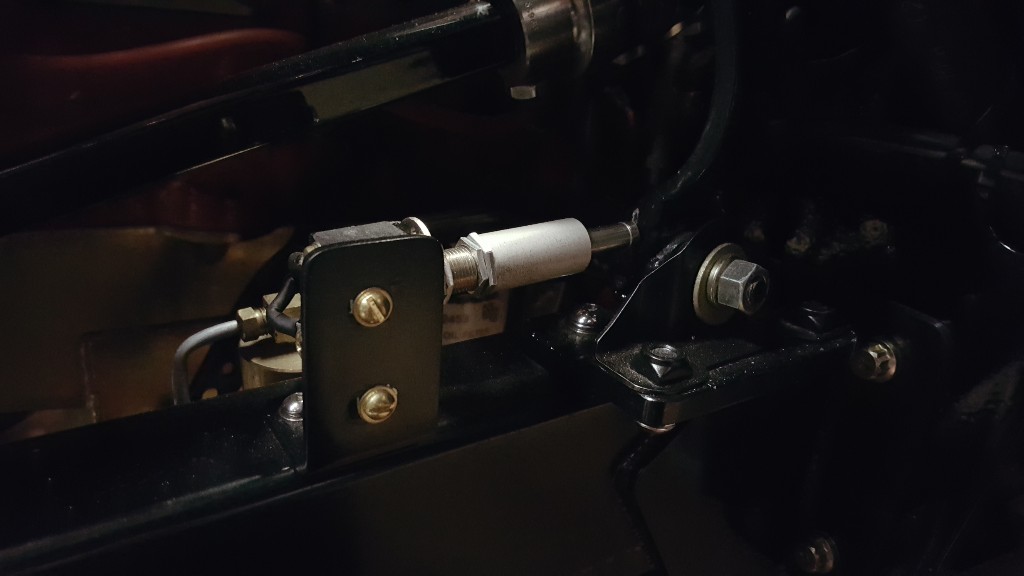

What kind of setup are you stick guys using for a clutch switch to control 2 step? I never had a switch on the clutch just button on shifter. Pics would be nice.

I use a Biondo switch working off the Z bar. It allows you to dial it in so it releases just where you want it to!

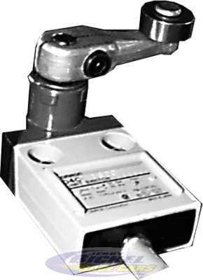

Default Re: Clutch Switch
Don's setup looks pretty nice.
I may have to try that on my next clutch job !
I've used the Jerry Bickel switch in the past which is a very heavy duty switch with molded in leads and an adjustable arm .
they also have a universal mounting bracket for it.
