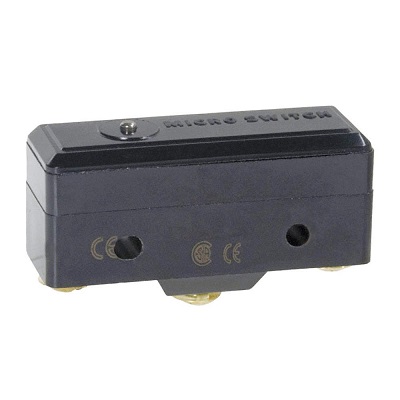

I found a bunch of surplus micro switches at a local electronics store (Orvac) that were $1.50 a piece. This is the quickest of the bunch, almost too quick and a little hard to feel with gloves. They had a bunch of different buttons and I picked one that suited me the best.
Name:	Micro switch1.jpg
