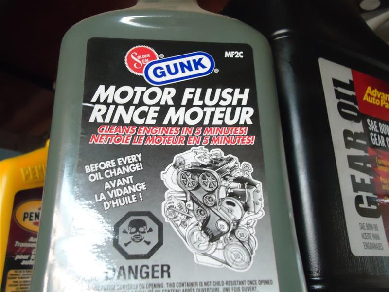

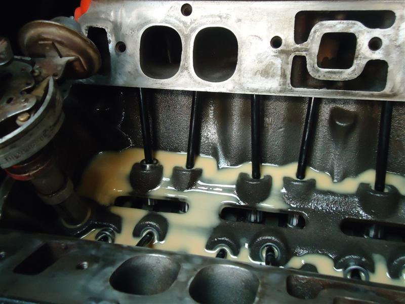

Thanks Mr.Evans and Class Racer gurus!
I guess the tricky thing is we are also trying to break in a big flat tappet cam at the same time.I also have this gunk stuff to help clean out the system . What about using a very good break in oil (AMSOIL), and the gunk combo as a "2 part deal" ? here are some pics...
