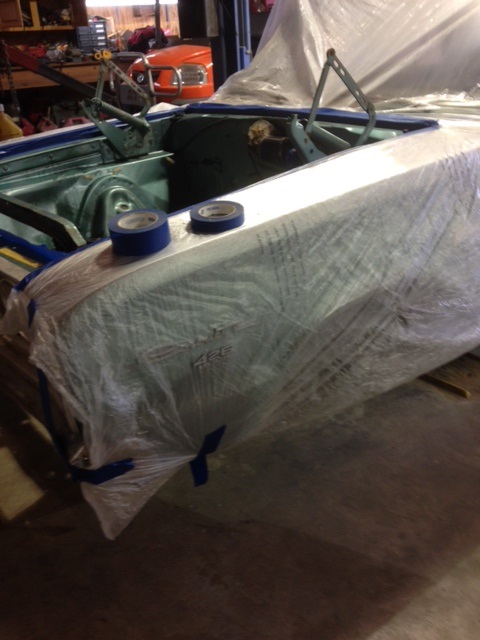

Engine compartment prep for paint. Tried a cleaner Cajun Brown which you cut with water. Did great. Treated rust with Ospho and then Bull Dog prep. All this is new to try so we will see. Protect the patina project.
ID:	35416   Click image for larger version

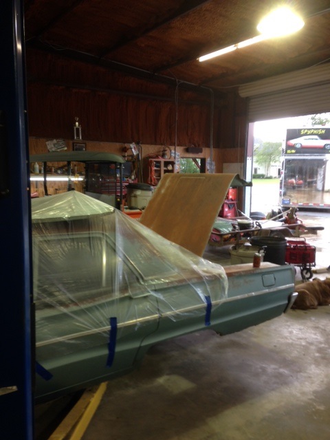

Engine room, tubs, front end with disc brake upgrade and overhaul done. Motor delivered to Reher. Dana rebuild next.

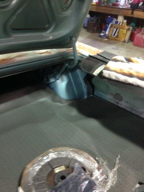

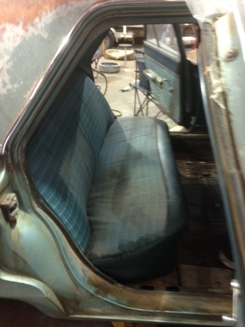

ID:	35843   Click image for larger version
