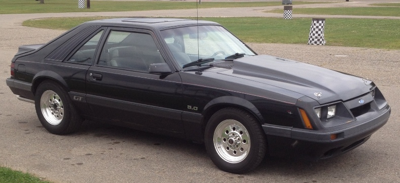

I consider it my daily driver plus I bracket race it whenever possible. The motor is mostly stock as I am building the car back to front if you know what I mean.
Motor: Bone stock 100,00 mile HO longblock with a K&N. Added FRPP 1.72's, underdrive pulleys
Exhaust: Shorty's with 2.5" Dyno-Max cat back
Trans: Warmed over AOD/ 2400 stall C6 style converter. Manual valve body w/ trans brake waiting to be installed.
Rear gears: 4.10
Manual rack
Electric fan
Power adder: None
EGR delete
Pulleys- March alt./ water pump with stock alt. pulley
Suspension- Bolt on aftermmarket upper/ lower control arms and Strange adjustable struts/ shocks.
Future plans: Mildly ported Iron GT 40's and Explorer intake when I get sick of this combo.
Leaving at 1,000 rpm- 1.876-60', 13.62 @ 99.40 MPH. Left the trans in drive and just foot braked it. On 235/ 60-15 ET Streets.

Don't port the gt-40's! Bolt them on your roller long block and claim a crate motor. I forget which it is but I think stock roller cam and gt-40's are the 215hp one. (hmmm,I might be thinking gt-40p's)
Excellent start!

Thanks. I would like to do something like that but my work schedule as well as the fact that the closest races are a couple hours away in any direction kinda makes it tough for me. Although I'm wondering if Milan has something periodically for points- not sure about that. The GT40's were already ported when I got them. I just had a little more work done to them. Unless I'm mistaken the CM class is for carb'd combo's? Mine is EFI as I'm not really a carburetor guy. I am building the car to mimic those styles of classes though as I think it would be fun to compete in PS or CM. Also, I forgot to mention that the car has Strange adjustable struts/ shocks as well. Plans this year call for anything that will make the car a little faster and help it stay consistent. Again, thanks. Mitch.

Think your car would run G/PS well under the 14.30 index and you have a lot more room.

Thanks. Yeah my work life/ home life wouldn't allow the traveling. I can sure dream though- LOL.
