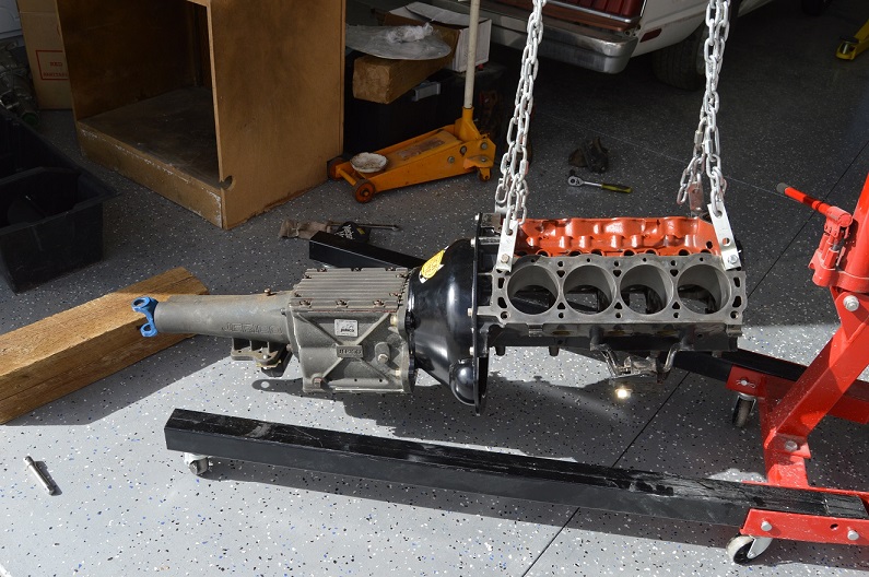

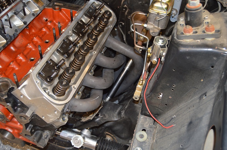

I’ve been working on the car for 3 months now. Lots of small things accomplished and I have acquired a bunch of parts.
Thanks to Sean Marconette who sold me his old, slightly used, Advanced Clutch flywheel. Called Rob Youngblood and he set up a clutch assembly to go with it. Plus Sean has provided a lot of advice on suspension and other stuff.
My friend who has a Nova stocker sold me his old, slightly used, spare Jerico DR4 transmission. Sent it off to Jerico for an inspection and input shaft replacement. Turns out it had a severely pitted 1st gear and had to be replaced. Bit the bullet and bought a Long ratchet shifter, ouch! Already had a Quicktime bellhousing.
Bought a TCI starter from Kevin Zaskowski on Class Racer.
Another friend sold me a new Painless switch panel that he didn’t need.
I have more parts and pieces than I have room for in my shop.
Ordered a rebuilt manual rack from Rock Auto to replace the power rack (same as a Fox Mustang). I received it in December and left it in the box until I needed it. Opened the box in March and of course it’s the wrong one. Turns out they are not available from them any longer.They allowed me to return it. Ordered and new one from Summit that fits and it was only $15 more than a rebuilt.
Decided to stay with the 4 lug hubs and brakes up front. Disassembled the front brakes and ordered new pads, calipers and brake hoses from Rock Auto. The parts didn’t fit, turns out the spindles had been replaced with Turbo Coupe spindles. I had to return and order new parts 3 times before getting the correct ones.
I’m pretty sure Rock Auto has my name in a file that says I don’t know what I’m doing…they may be right.
Last year I determined that if I was going to build a race car I better learn how to weld PROPERLY. A friend and I decided to take a MIG/TIG welding class at our local community college. We don’t take the class for credit so it only costs $135 per semester. It was one of the best decisions I’ve ever made. Not only is the instruction first class but the machines are newer Millers and they have over 50 of them. My Mig skills have improved 10 fold. Tig welding still leaves a lot to be desired but I’m getting better. We are allowed to bring in projects so I’ve built my seat to floor brackets and an aluminum weight box. This is my second semester going for a third in the fall.

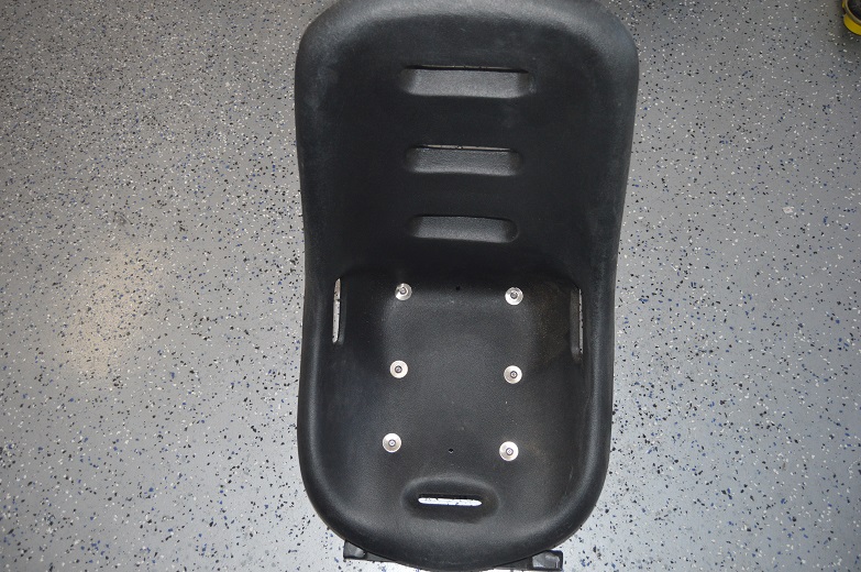

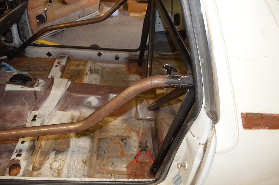

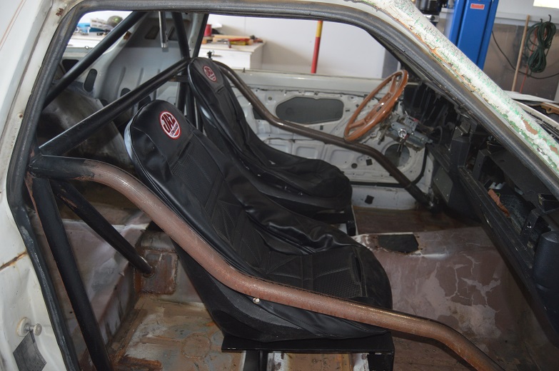

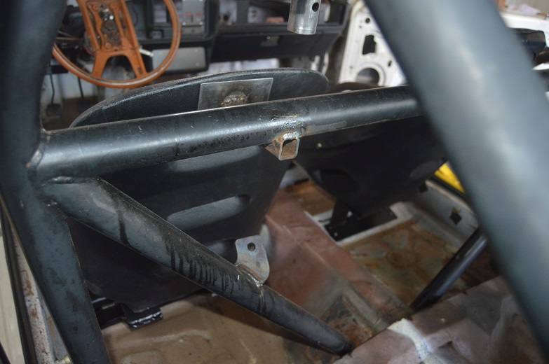

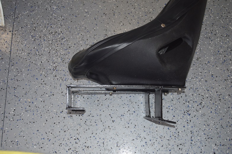

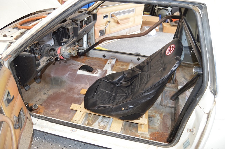

When I bought the Fairmont it had an 8 point mild steel roll cage already installed. I decided since I'm running in a slow class I would remove the halo and the 'A' pillar bars. I needed to save some weight but I still wanted protection from a faster car side collision and roll over. If anyone could see how tinny these cars are it would scare you! No need for a certified roll bar at this point.
Getting in and out of the driver’s seat was a real pain in the butt, literally, so I added a swing out door bar. I'm 65 years old and the joints don't bend like they used to.
Once I installed the swing out bar I mocked up the JAZ plastic seats. For some reason only know to me I thought that using a high back seat would limit the visibility out the right side of the car so I opted to the low back seats. Because of the low back seat I had to add a head rest to the roll bar, and since I was already in the welding mood I attached a seat brace and a shoulder harness tab.
I used good old 1X4 wood planks for the seat mock up to set the height and angle. I built the seat to floor brackets out of 1/4 aluminum sheet which I sheared to my liking and TIGed it all together. I made the passenger floor bracket a little lighter as it should be unoccupied most of the time. After reading lot's of comments about these seats on Class Racer I bolted them all the way through the seat but I left the internal nut and used it for a little extra strength.
Front fenders, hood and trunk lid are off to the body man for straightening and paint.
