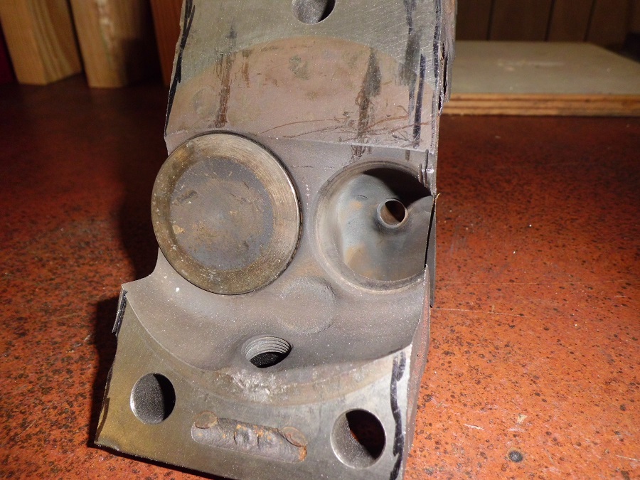

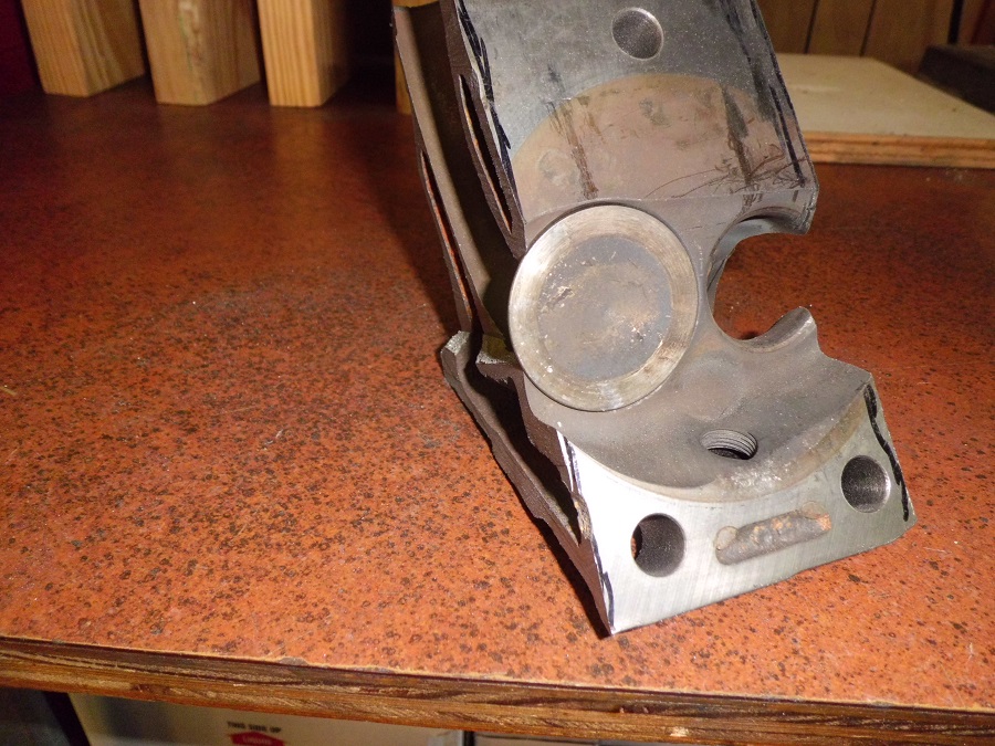

This is without question a positive checking tool

Send it back, Larry. Got to be a cheap Chinese piece and won't last a week. Look at that machining! What did they cut it with, a rip saw?

I had a lumber jack cut it with a chain saw

seriously,
because of angle milling and valve radius etc it is only specific to my engine. I initially cut the damaged head out of curiosity then realized it could be a cool visual aid.
I may touch up some of the chain saw marks with a rasp
Larry Woodfin 471W
