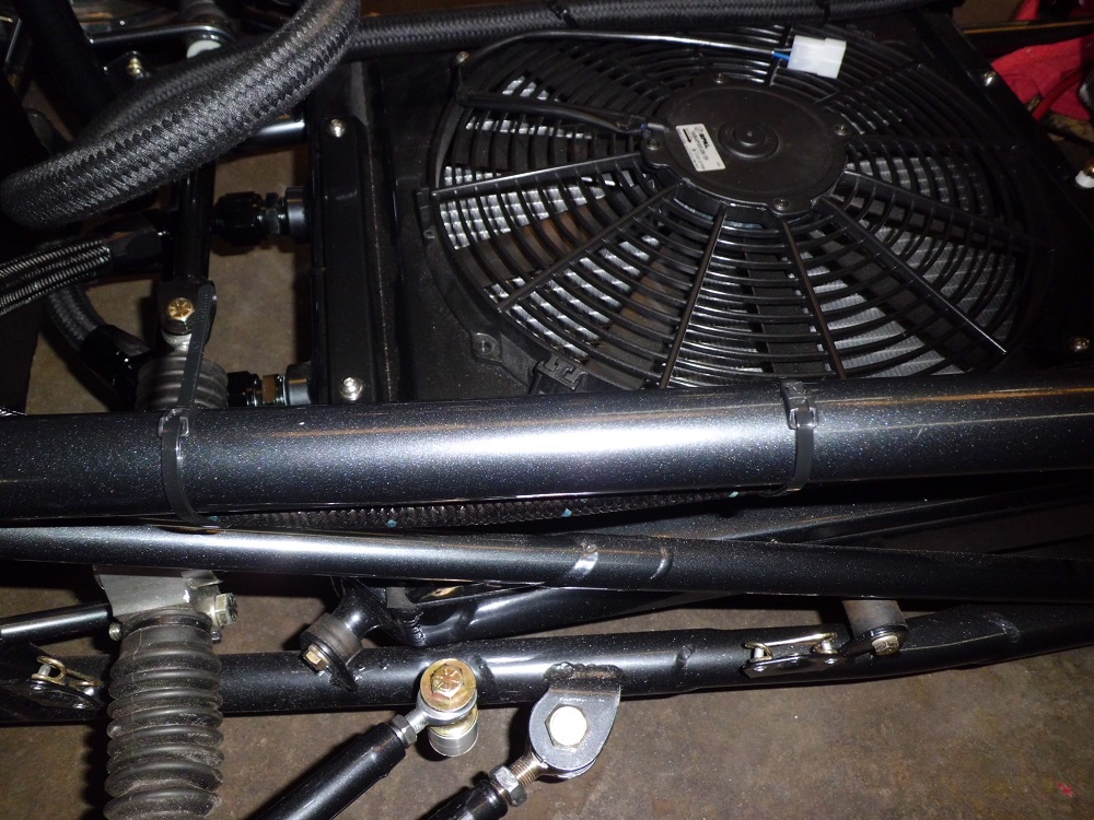

consider experimenting with the "Cobra Head" ties. The design allows the cut off tail to lay flat against the wrapped section.
