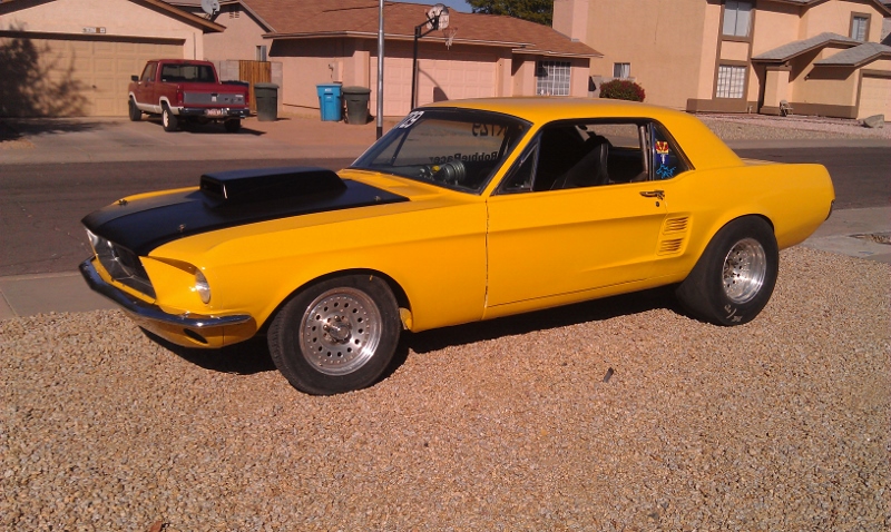

Well I have a fantastic news update! I sold my 67 Mustang bracket car so I now have the money to fund this project. That will make life much easier. I will miss the ole girl but it was time. Ten years and lots of fun but I really look forward to Class Racing.
