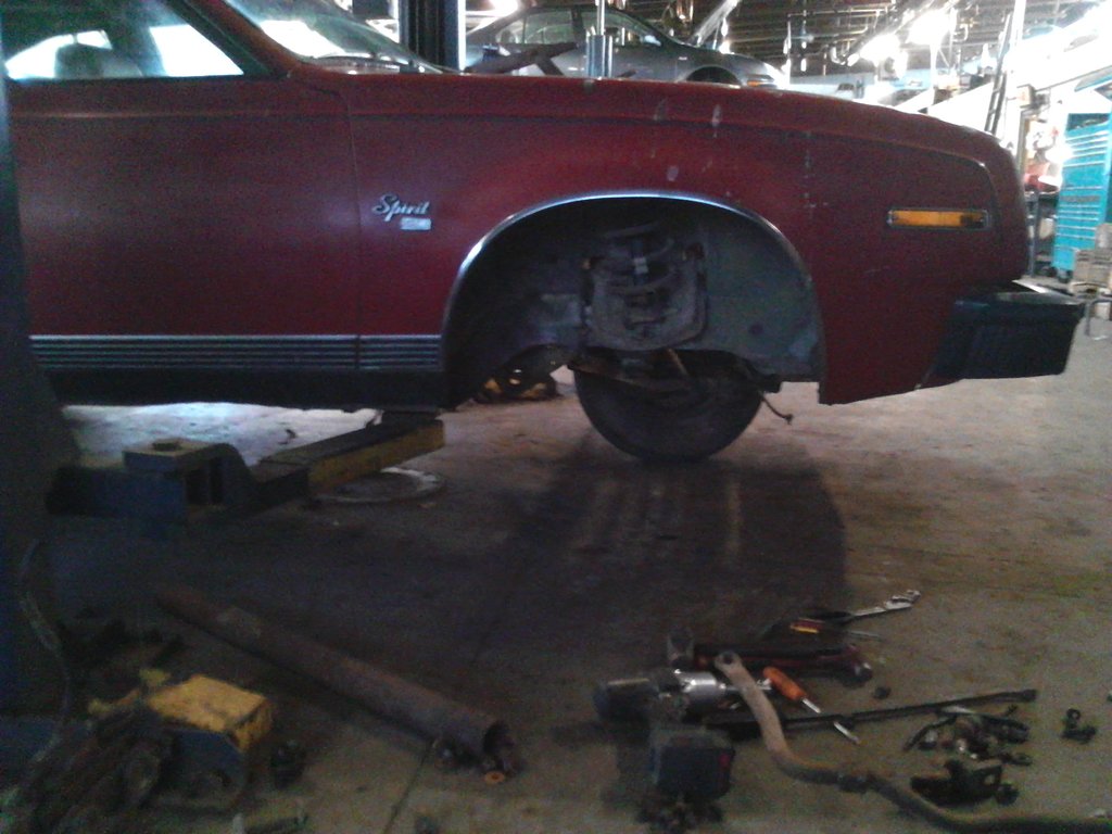

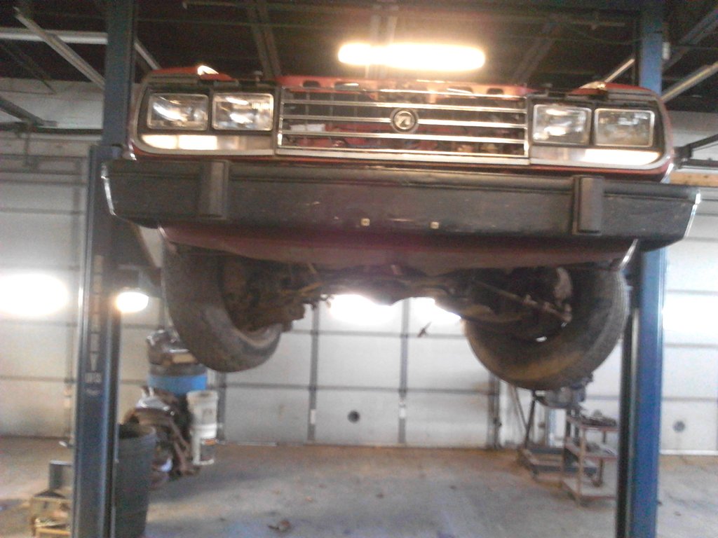

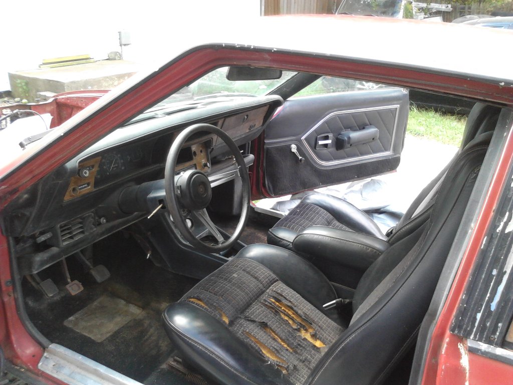

Got underneath the red Spirit and initially things look pretty solid other than a place in the floor right behind the driver seat. Wonder if the mangy possum nest I found there had anything to do with that?
Loaded her up on the trailer and took it into the auto shop for a real good going-over. Very solid underneath as it turns out, so the Ziebart people did well on this one. Found their sticker on the driver door jamb.

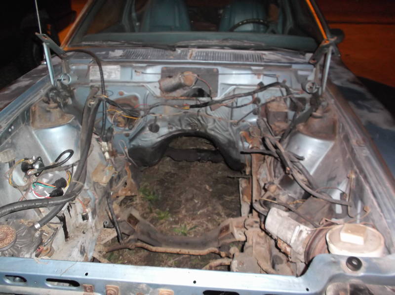

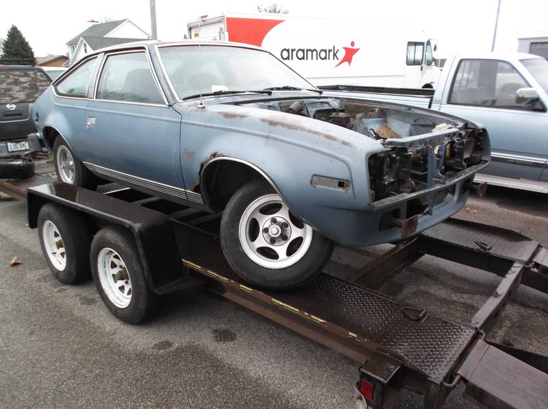

Now we've got something very suitable to work with. This car is an original manual steering manual brake stick car, so its a great platform to use. There will have to be one important piece changed right at the beginning, and it's a monumental headache. I know this because I've done one before. On AMC cars you have to have the proper engine cross member in place for the type of engine you're wanting or the engine mounts won't line up. The 4 cyl one will have to come out and be replaced with the 6 cyl one out of the blue 80 car. The nasty part of this is that the lower control arms bolt into this cross member, and to remove those means removing almost everything else suspension related first. And I'll get to do this TWICE! Get out the breaker bars...

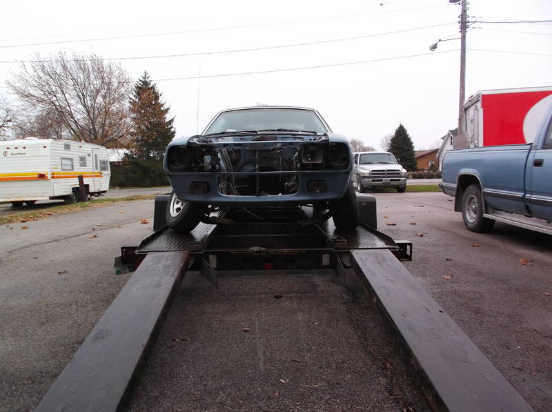

The blue 80 car now gets parted out so I can use a lot of things off it. And here we go. You'll notice that when the dirty work was done it was just a little bit hard to steer due to an "alignment problem". Getting the hulk back up on the trailer took a while!

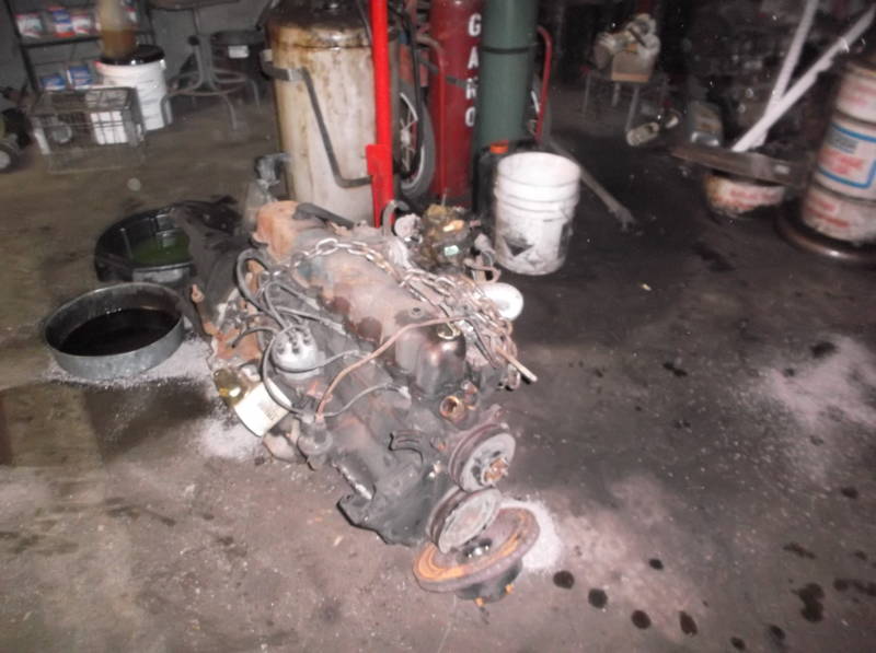

The engine and trans from the '80 needed a bath real bad so those went to the car wash in the back of the Dakota. That poor truck sees nothing but abuse from me, it's kind of like an old farm truck, but that was it's purpose when I got it for cheap already pre-wrecked in the back. Once the engine and trans are clean, I'll take them to my workplace where it's dry and heated.

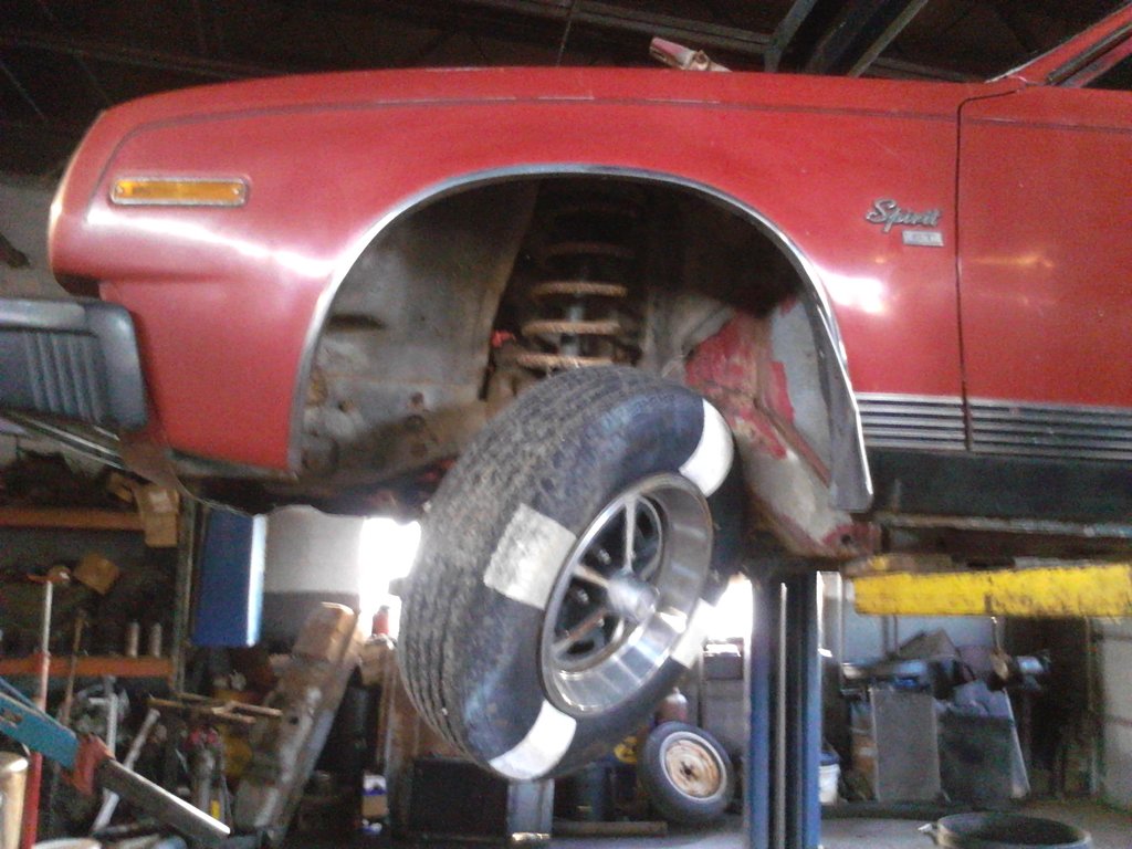

I have some parts ordered to get the front end work done, turns out doing an AMC car is not quite as easy as opening a catalog or making a list from an internet site.
Since I work at a NAPA store, getting the regular suspension and steering replacement pieces wasn't that bad, but trying to get the trick shocks and springs took some research. Turns out I did OK on the shocks, which are the same type as a lot of Mustangs from way back when, but the springs turned out to be a problem. Despite a well known Florida company's listings that say they fit the early Fords from the '70's along with 71-up Javelins, Hornets, Gremlins, Spirits and such--they don't work. The spring holders on the upper control arms require a much larger diameter spring distance across the bottom to fit in right. The top coil diameter would have worked, so I guess they were half good for my application. I had to leave the 4 cyl original coil springs in place for now until I get something figured out, may see about a re-work on my spare upper A-arms I have from the '80 car to move the spring perches inward at some later time. The rest of the pieces like bushings and ball joints went in place as expected.
I have a whole new appreciation for mechanics who do front end work day after day. Dirty hard work! Hats off to you guys.
Since I'm being loaned a bay in an auto shop, getting the car mobile as soon as possible so it can move out if the bay if needed is kind of primary. I'm not putting the new steering parts on just yet, need to concentrate on getting the cross member switched out and everything that attaches to it back together ASAP so the body can at least become a roller again.
You'll notice the similarity of the bad wheel alignment of the red car to how the blue one ended up in previous pictures once the cross member came out. Once the lower control arms come out of it, they just flop everywhere.
This part of the build is no fun.
