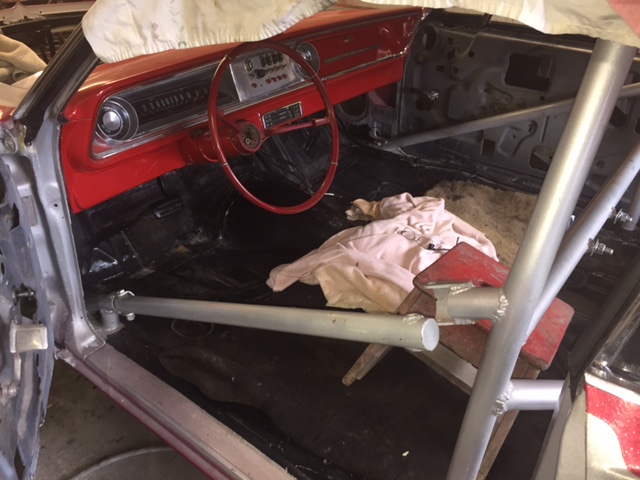

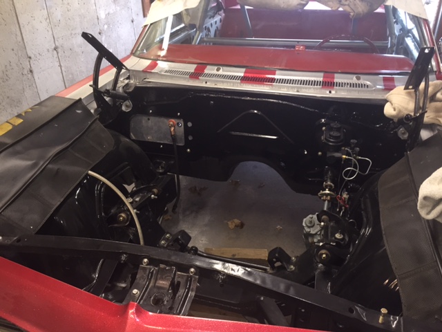

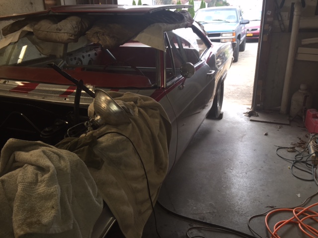

Just a quick update. I compound buff paintjob, installed most trim, just waiting for missing pieces. Finishing up brakes, elrctrical ect. Carpet coming in next week to finish off interior. Will be installing a BBC block to mock up for tranny install. Making car ready just to install motor probaly in early next year by Feb.
Will Lamprecht Div 1 65 Impala 396/325 I/SA in progress
