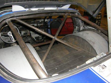

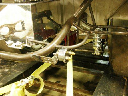

I'll give you a sneak preview on your thread. I had to be a little innovative on the wheel tubs. I bead rolled every 3" before I broke 90's on the center section between the tubs to give it some rigidity.
The fuel cell is directly under the original fill lid, and you can see my battery mount, master cut-off, fuel pump and filter
Ernie Neal
SS 354
