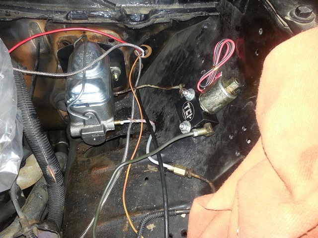

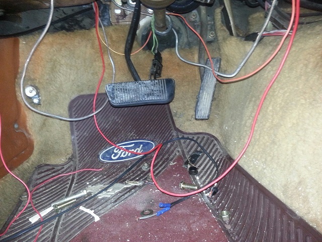

Finally this weekend we got to do something constructive. We got the manual master cylinder in and plumbed. Along with the line lock. Still may need to fiddle with the brake peddle. Next step is straighten out and bleed the brakes. From the pictures it is a mess. We have most of the wiring roughed in. We have the gauges placed. They too are at present, roughed in.

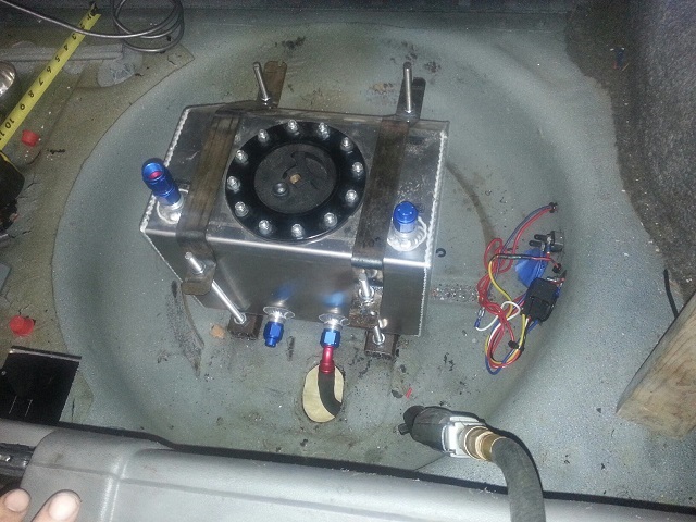

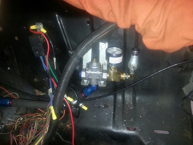

Some time was spent on the Mustang II today. We finally have the brakes back online. There is still a bunch of wiring to do, as well as clean up. As you view the photos, this is evident.
We got the fuel cell mocked up. I need to do a final finish on the brackets, clean them up and paint them. We have the fuel lines run up to the regulator. So, progress is there, albeit slowly.
Looks like the next step is to change out the cam. Put the new Bullet stocker cam, lifters and the adjustable rockers in. Not far from a point where this car may be able to run under it's own power again.
