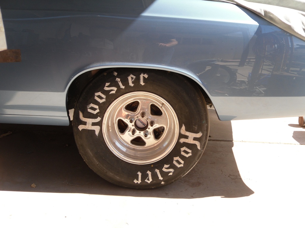

At this point I have the patch panel welded in with one of my usual ugly welds, and I'm most of the way through grinding the welds down. Of course if I were a better welder I'd be done with that now! And damn, MIG welds are hard!
But this morning I test fit the slicks. Later today I'll put the jack under the rear to move the tire up into the wheel well in case that results in a tight spot I haven't seen yet, but so far it looks pretty good. The front bottom corner is a little tight. I am considering trimming that back a bit:
It looks like I'm a bit limited to how much I can lower the rear but I think I'll be okay here too:
Finally the inside looks like about 3/8" minimum clearance. I might consider a very thin spacer to move it out just a bit depending on how the outside looks when I jack up the rear:
I also might have to tweak that body mount behind the tire just a bit, but I suspect that will not be necessary either.

Dave,,, as I'm scrolling down looking at the pictures, I was thinking about your inside clearance, since we have to run a spacer behind the wheels on my son's '72 Malibu. You look to be a little tight there as well, so I guess a '66-67 inner well is no different. By the way, which engine combo are you leaning towards?

You're probably right. I'll see how the outside is when I raise the rear, if there's more clearance there than the inside that will settle the issue.

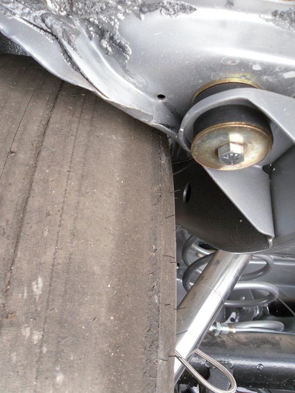

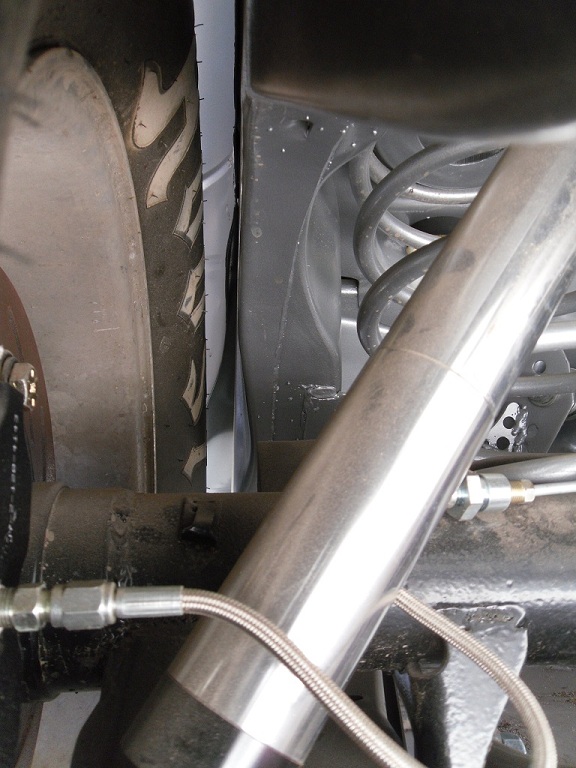

This is the minimum ride height that I could imagine running. Clearance starts to disappear pretty quickly as it goes lower. Inside clearance looks to be about 1/2", outside clearance about 3/8". Front and rear are the tightest here as well, with 3/4" in front and 1/2" at the rear.
The picture below shows the tire at approximately the ride height I would expect to use. The inside clearance here is still about 1/2", all other clearances improve substantially.
I think the body mount itself is fine, but I may have to do a little work on the lower inside corner of the inner wheel well.
As the body comes up further all clearances except the inside improve. The inside drops to 3/8" in some cases. Overall I think I like the wheel and tire exactly where it is, I don't think I'll use a spacer. If I do try one it'll be the thinnest one I can find.

David, That first picture is plenty low. It appears that the center line of the axle is above the top of rocker panel (bottom of door) which is where the factory intended it to be.
If it was me, I'd make a little curved pie cut in the front and push the lip forward to meet the quarter.
Oh boy..More migging.
You can probably get away with what you've got , with radials.
I'd grind away a bit of that body mount, and then a generous application of a Ford tool will fix it all right up.

Okay Dave as a Person who has Been There Done that WITH a Stocker with suspension You DO NOT Need to cut outer Body. The Front INNER wheel house MUST BE TRIMMED or it will chew it up on launch and leave. Also Roll the inner Rear to be safe because it can rub. 30 X9 Hoosier Radials and tested with 96" M/T too as well as 29.5 x9 M/T Bias. I have already covered ALL the options you are mulling over. You will like that bar Too.

Thanks for the info. I'll look at the front inside again, it makes sense it would be tight there. And I was definitely going to buy myself some clearance on the rear inside corner.
