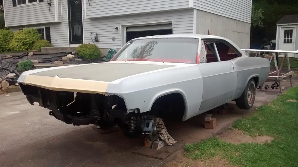

Originally Posted by impstocker View Post
Update. April 1 cover came off of Impala. Meanwhile I built a real workbench and organized my garage. One pic is with front fenders attached. Looks like real car! Only helb by few bolts so I can remove to finish front suspension, brakes ect. Trying to go "B*lls to Wall" with project so I can run this year. Will have rolling chassis complete and wired real soon. Back to bodywork paint. I will be picking up a better trunk too. Just looking for a passenger fender front extension plus rear trim under trunk. (high $ that part) Interior started too with headliner going in. I will be rebuilding the 306/325 HP engine I had in my green 68. That car went 11.71 with that motor and stick. Meanwhile I built a tribute Grumpy Camaro. Yea only a model, but I did build it.

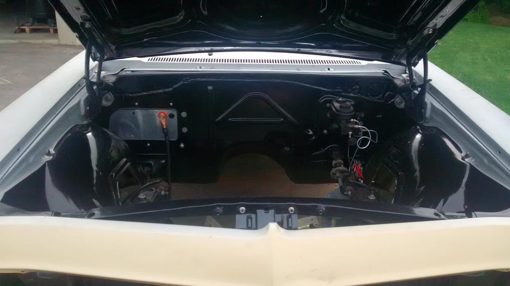

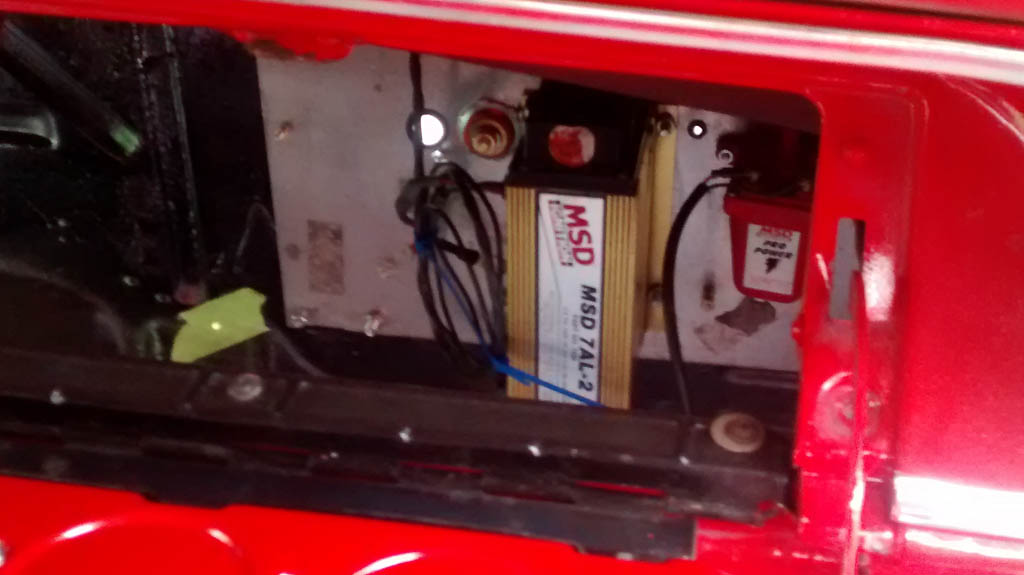

Where car is at today.

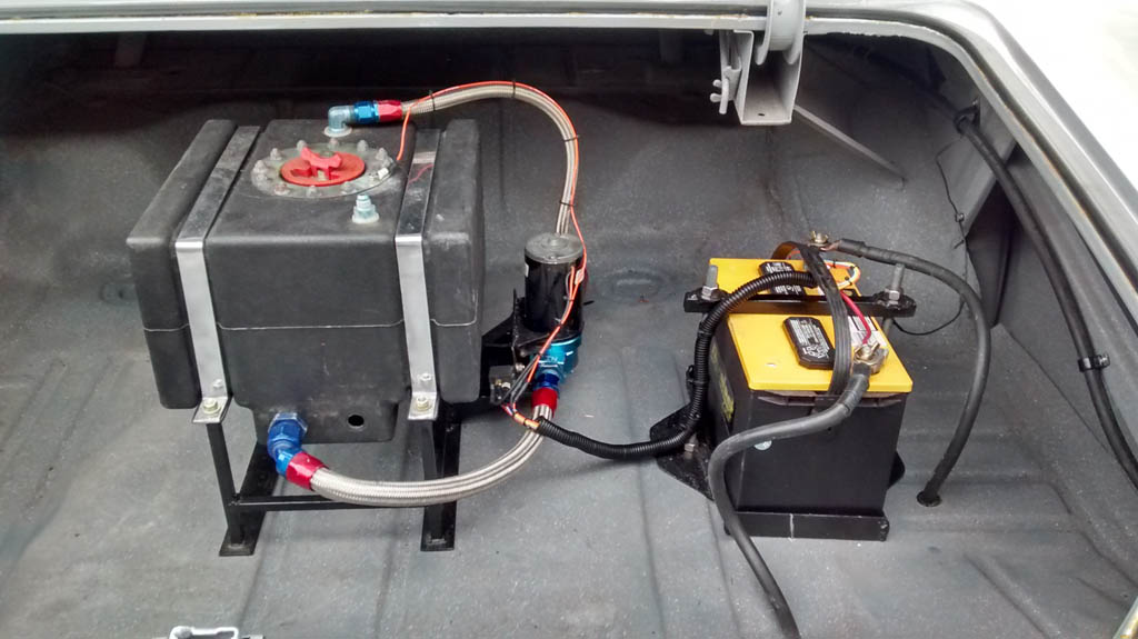

1) Fuel Cell/Pump / Battery installed. Just got rest of braided line to go up front. When I last used this fuel cell I have a AN Fitting plug for the unused outlet but it would drip leak. Any suggestions to seal including sealants?
2) Ignition mounted on the dash side of heater core block off plate. Battery cable runs up to a lug on this plate then a separate cable to starter. Battery cable #1 welding cable.

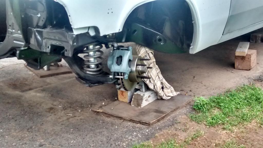

3) Front suspension with QA1 Adjustable shocks. Right now set on the "80/20" setting. Six cylinder springs with 1.5 coil cut out. Stock disc brake conversion. Lighter drag race version part of the "later upgrade" list. Master Cylinder from 83 Dodge.
4) Engine compartment. Basically waiting for the 396!

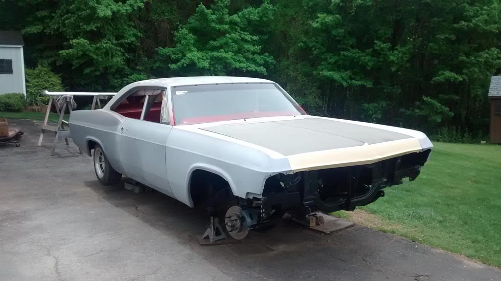

Here are body shots. Just need to get passenger side front fender extension. Also have a better trunk lid on the radar next couple weeks. I will be painting myself. Not a "dime rocket" but maybe a "50 cent rocket"

Looks Great! However I would lower the fuel cell. I got tossed at a Div 7 National event because the top of my cell was higher than the top of my rear wheel house. I had it mounted above my spare tire well to clear the tire i was using for ballast. Plus the "gravity" of being high up can cause fuel to flow past the floats causing the motor to hydraulic.(You can ask Wes Mcgann about that.) Just an FYI to help you prevent an issue later.
Earl's Stat-O-Seals:
http://www.jegs.com/p/Earls/Earls-St...38544/10002/-1

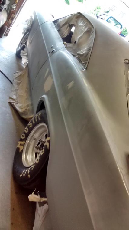

Just had to post this. I mounted slicks and threw them on to make sure for clearance. Starting to look like a "real drag car" now. LOL Paint on the way- next pics will be of painted car. Then we work on motor/tranny.
