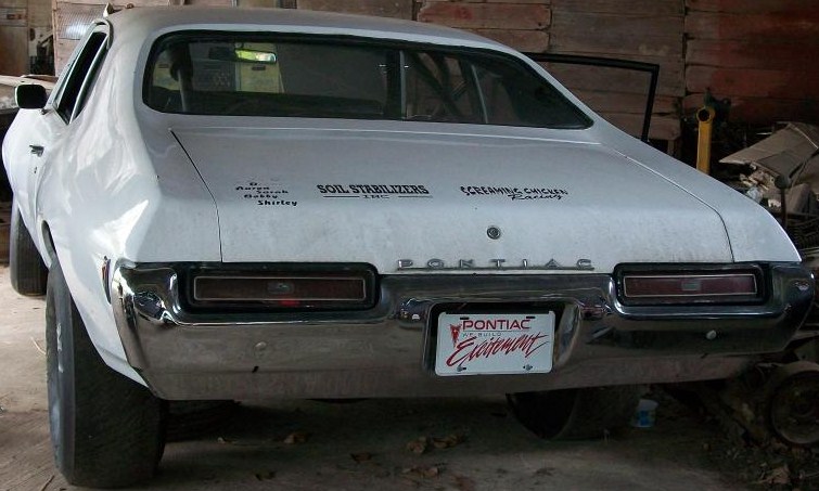

I bought a '69 Tempest 350HO ex-Stocker to run bracket with. The dyno sheet said it made 434hp. But it was not tricked out. Just a stock rod, TRW engine. Ran mid 12's. I had a diesel crew cab, a two car gooseneck, and 2 Pontiac powered bracket cars, for the 2010 season. But our local track did not open the entire year. Sold the truck, trailer, T-body and the #48 heads.
