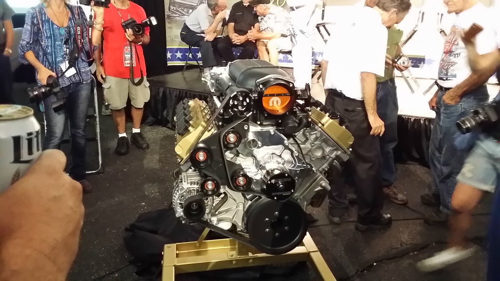

Maybe they need to try this pulley setup.
Dan Wilson, STK3171, K/SA
