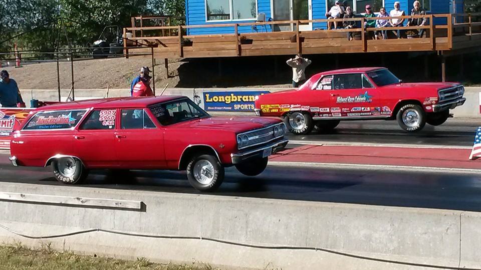

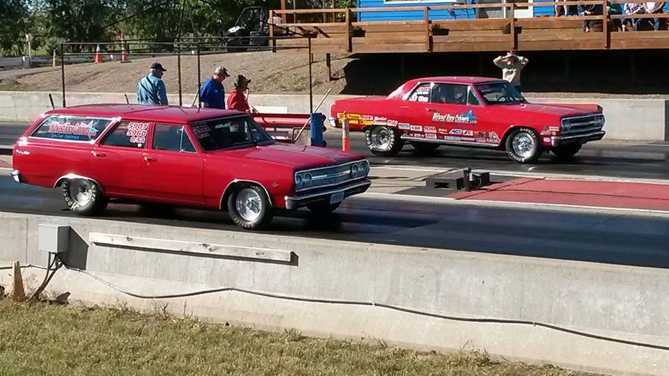

Both my cars! Me in the Chevelle and Dave Magee in the wagon.

I like that geezer deck on the starting line.
