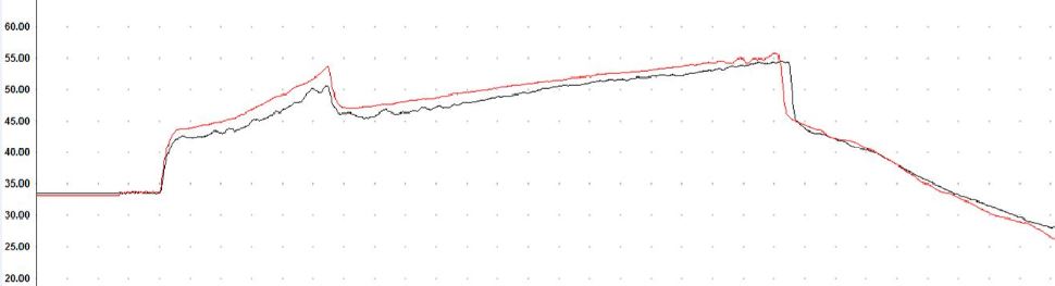

I installed a data recorder to track engine RPMs this past weekend and on the two passes where the car fell off, the RPMs are very shaky from about .07 into the run. I will try to post a picture of the graph later.

Attached are RPM graphs with the red line showing a "good" pass and the black line showing a "bad" pass where is slows .2

I haven't had the privilege of reading many of these graph's but with the black line rough, does the engine have an intermittent miss ?

There is not a noticeable miss. With the lower stall of the converter you can feel that it is on a lazy pass. The up and down movement in the black line equals about 100 RPM.
