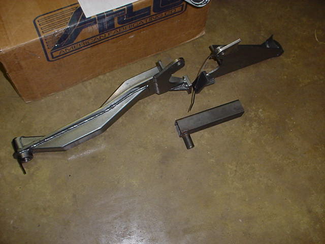

I agree with Chad, you dont need all the hassle changing to a 12bolt. Trailing arms are just one of the problems, keep what you have.

Bob who make those trailing arms in the picture?
