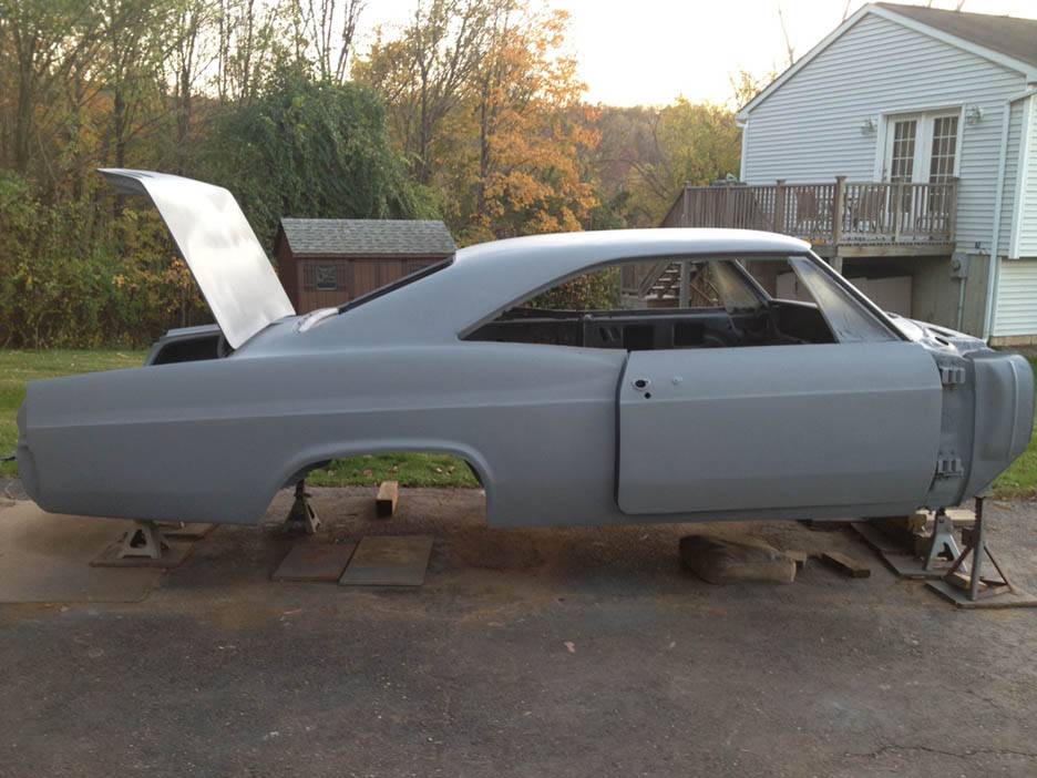

Rough bodywork is finished. Floor Pans and new trunk installed. Working on mocking up roll bar with frame out of car, attach frame than weld roll bar in. I will have more pics soon.
This might not be a "dime rocket" but I have less than $3000 in this car which includes the purchase price of $1600 delivered from Delaware to NY. Would I use this as a street car restification", no. as the rust repair has been a lot especially with my amateur body work skills and the $199 super Chinese welder i have been using which finally took a crap. My next $ outlay will be for a new and much better welder in 2 weeks.
Really my only big $ outlay will be a converter- I have the rest including rear, 396-325 motor from my 68- I yea, I can use roller rockers now, still have stamp steel rockers in motor, but never broke one when I was racing- probaly due to the low .398 lift. I used regular Crane rockers, not the long slot ones either, never had a problem-
Have to dig my 77 Crew cab dually Chevy truck out to tow wuth and get a trailer too-
Can't wait -

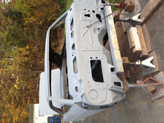

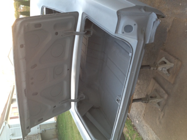

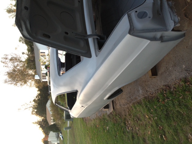

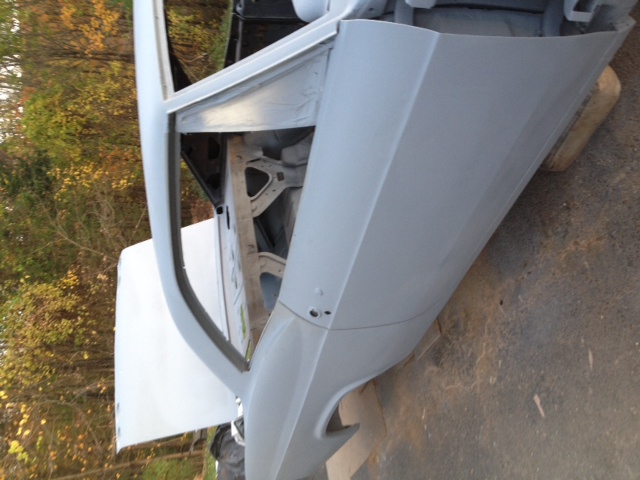

Default Re: 1965 Impala BBC Stocker Update
more pics
My neck hurts too- here are pics fixed.!
Will
