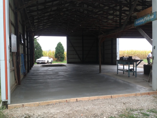

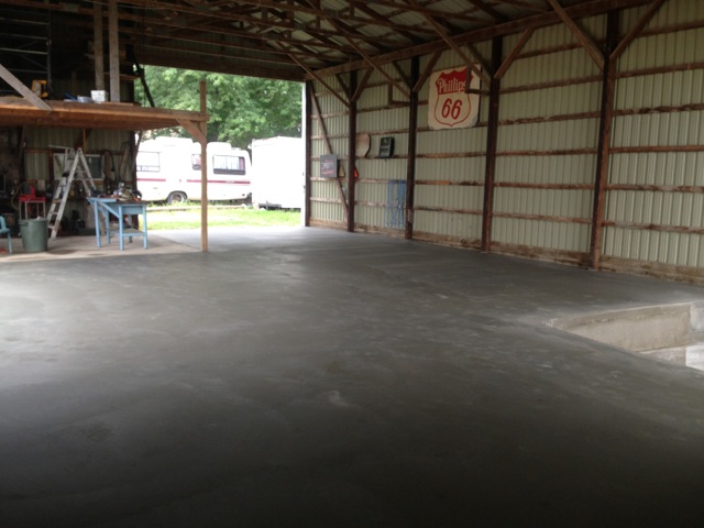

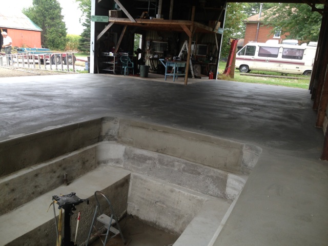

We got our floor poured this week (hope the pictures show up) put the drain in myself , might be too big --- Trevor
