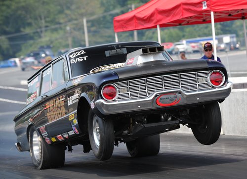

A friend of mine races Division One Super Street, 10.90 index, .500.pro tree with his foot brake bracket car , no transbrake or throttle stop. I will try to post a picture. It is not the easyest way to race, but he can make it work.
he seems to make it work very well...
