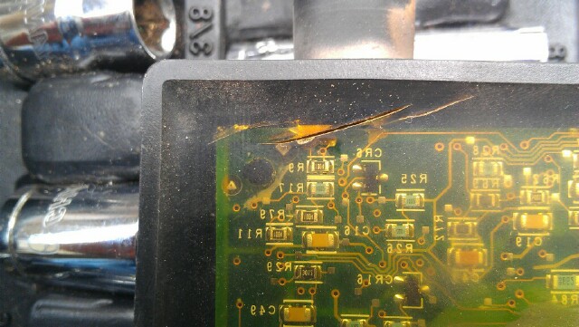

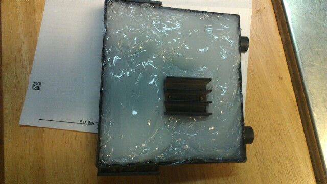

Old 09-02-2012, 10:40 AM   #27
erkme73
Join Date: Jul 2012
Posts: 6
Default Re: Onan info
Ok, here's my latest update.
Backstory:
My 7000 Marquis (gas) has been shutting down randomly WITHOUT generating any error code. As documented in my posts above, the unit would shut down abruptly as though someone had pressed the stop button. The reported error code was always an old code from a previous abnormal shutdown (i.e. low oil, fuel delivery).
Discovery since last post:
I removed the control module to inspect it carefully. The open side is filled with a clear epoxy/silicone material designed to encapsulate the circuit board and keep it dry. There were several pronounced cracks in this silicone in the corners. The cracks were deep enough to reach the PCB - and in one corner, the board and silicone were rusty colored (picture attached).
Actions:
Figuring moisture ingress was the likely cause of the intermittent shutdowns, I carefully and methodically stripped the silicone off of the board using a small flat-headed screwdriver. The glue came up surprisingly easily. I was unable to remove the PCB from the housing since the glue between the board and the housing was inaccessible. I then put the the module in my toaster oven at 175 deg F (no, I'm not kidding). I let it bake for an hour. As soon as it came out, I filled it with clear GE silicone II caulk from Home Depot for about $6 (picture attached). I let it sit overnight. The following morning, I reinstalled the control module in the genny, and let her run.
Results:
It's now been running for most of the morning without a single shutdown. While this doesn't mean anything (the random shutdowns sometimes went many hours between events), I'll let it run all day (and into the night if need be) to confirm that the shut downs are eliminated. I will post back my results once the testing is completed.
Given that my situation seems unique (shutdown without error code), I don't know how much my troubleshooting will help anyone. However, at a minimum, if you've performed all the possible diagnostics and are left with replacing the ECU, before you do, inspect the sealant carefully. Unless something is toasted on the board, you might just be able to revive it.
I figured I need a new board anyway - so I'm not going to break it more than it's already broken. Besides, I can learn more tricks this way
Name:	Onan ECU original.jpg
ID:	13445   Click image for larger version
Name:	Onan ECU resealed.jpg
erkme73 is offline   Reply With Quote
Old 09-02-2012, 04:13 PM   #28
Rich Biebel
Rich Biebel's Avatar
Posts: 2,320
Likes: 25
Liked 555 Times in 216 Posts
The part number is 300-5047 for that A-1Controller as Onan calls it...
The boards fail regularly and there is NO visual area to see that is faulty.
They generally fail with heat and I let a unit run on my bench for a while with a resistive load bank connected to it....
Once it is good and warm.....I shut it down and let it sit for a while....It heat soaks so to speak. Any unit that has had intermittent shutdown problems will usually start to do it once I put them thru this test. As soon as the unit starts to shutdown......I replace the PC board/control and continue the same test and the units no longer shutdown...

Old 09-02-2012, 04:18 PM   #29
erkme73
Join Date: Jul 2012
Posts: 6
Rich, you may be right, but for $350, I'll take the chances that it was moisture getting to the 'rusty' part of the pcb. See the photo showing the large deep crack in the original sealant. After drying it out and resealing it, I've got 6 straight hours on it now, and it hasn't skipped a beat.
I just upgraded my 36' Damon gasser (the source for this generator) to a 42' Tiffin Phaeton diesel pusher. It has a 10k quiet diesel onan.
The only reason I want to get this genny fixed is so I can sell it to the next guy with a clean conscience. I'll let the buyer know that if the generator starts to shut down without error, they'll need to buy this controller.
Old 09-02-2012, 05:51 PM   #30
Rich Biebel
Posts: 2,320
Likes: 25
Those PC boards sell for $450 and I have seen them sold on various websites for over $500
I have seen the potting material split and cracked as you described.
Moisture is definately not a good thing for a PC board to be exposed to...
If you got it working with no shutdowns.....great.....
