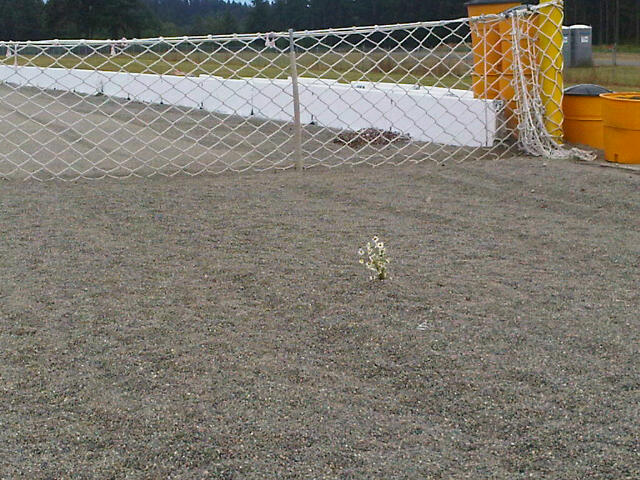

Seattles shutdown is pea gravel.Just saw a touching picture
posted on another site by a Seattle worker.
It has gravel, however is not deep enough.
