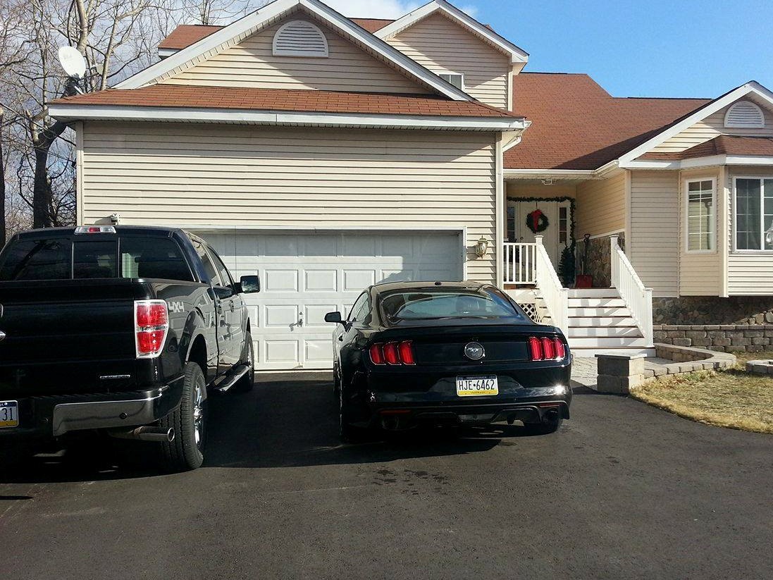

Robbie is that a 50th anniversary car? My wife drives the same car! I thought it was pretty funny it has a factory line lock in track mode!
Really? Oh crap, now I may have to trade in my 2014 V6.

It is a 50th Anniversary car too. Yours must be a 5.0. Ours doesn't have the line lock. At least I haven't found it yet.
