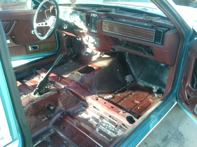

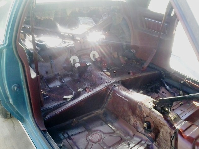

Thanks much for the input. As I said before. I want to do it right the first time. I had the day off yesterday so i made some headway.Is it possible the door bars are spot welded to the door skin? It looks like they are spot welded in about 10 places top and bottom of the bar.
Old 12-01-2015, 08:26 AM   #36
RobbieRacer
RobbieRacer's Avatar
Join Date: Jul 2012
Location: Phoenix, Az
Posts: 320
Likes: 17
Liked 118 Times in 41 Posts
Default Re: 79 Mustang project U/SA
Two pic's of what I got done.
ID:	31756   Click image for larger version

Time for the heat gun and scraper to get rid of all the rubberized coating on the back floor and tunnel.
