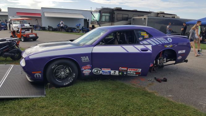

I have seen several Factory Showdown cars with dual rear calipers.

Dual rear calipers will help hold the car on the starting line if you want to get up on the converter. Master cylinder may need to be upgraded for the additional volume.
Line-lok on the rear isn't legal. Have to release with the pedal.
