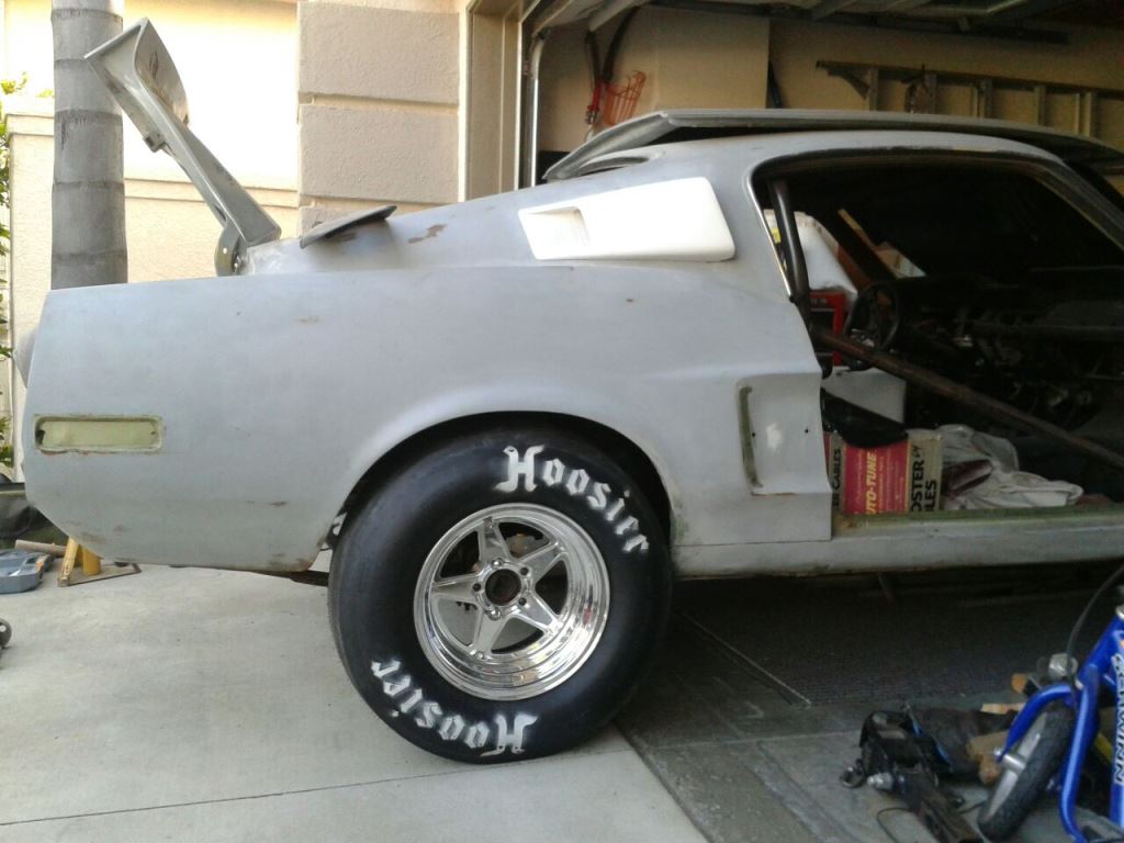

9x29 Hoosiers on 10" rim without trimming, used a BFH to help them fit. There is more room in the front than the picture shows, should also fit okay once I have all the weight back in it.

Ahhh,, the trusty 'ol BFH. No tool box should be without it.
