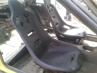

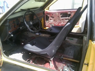

I thought I would go ahead and post an update.It's been a while. I have made a little headway. I got the dash repaired, painted and installed. I mounted the seats on the factory seat rails. They were too wide at 14 inches but I swapped them from inside to outside and they are only 9 inches wide. I mounted the seats on plate steel then mounted them to the rails. It came out real good. Nice and solid.Also got the brakes done. Nothing fancy but they work. I might up grade them later.
