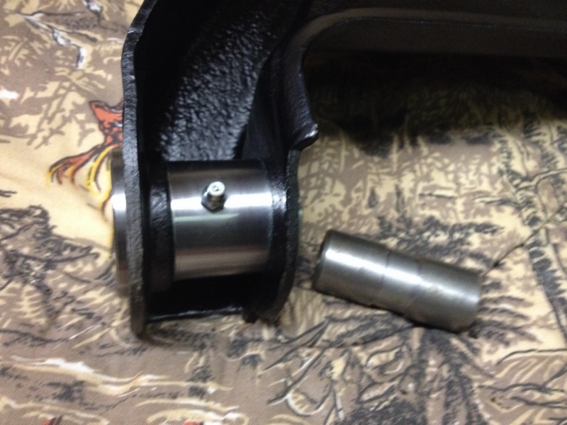

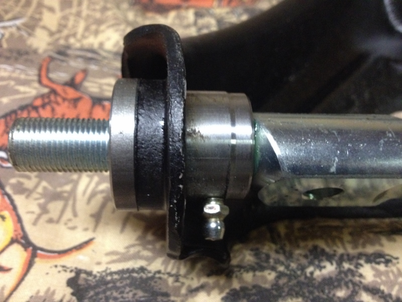

J&S Racing 01-18-2014 08:52 PM
Re: front end 69 nova
2 Attachment(s)
Attachment 22650
Attachment 22651
Did the install on mine today. Overall not that bad.
