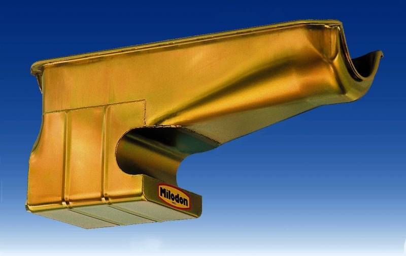

There are several other oil pans in the NHRA Accepted parts list, for other applications, that are welded and not stamped.
As an example, the approved Chevy II Milodon Oil Pan, P/N 31060 is welded.
