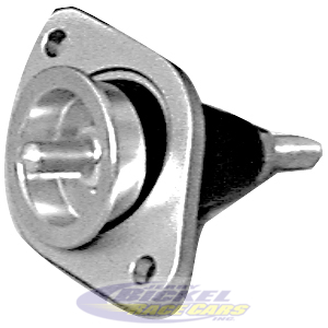

This part from Jerry Bickel Race cars is simple and inexpensive .
I use it on all my builds.
Part number JBRC1064 $69.00
I have made the cup and welded a stop on the pushrod to function like this unit, but for the price and quality of this assembly, it's an easy decision to just use this piece. A positive pedal stop will provide an extra margin of safety.
I've seen a number of cars torn up and people hurt as a result of inattention to this.

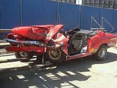

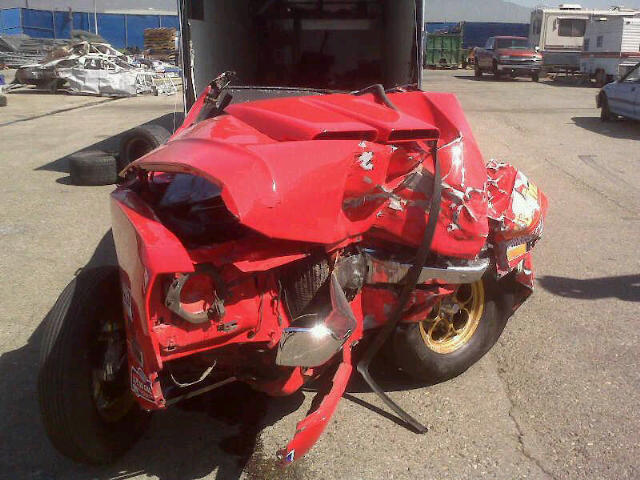

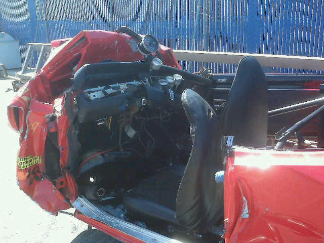

This is what happens when the pushrod comes out
ID:	53977   Click image for larger version
ID:	53978   Click image for larger version
Rod Greene Real men shift for them selves. Slowly working on TA Challenger for D,E/S and a 72 Challenger for SS/K, L as if I don't have enough other projects.
