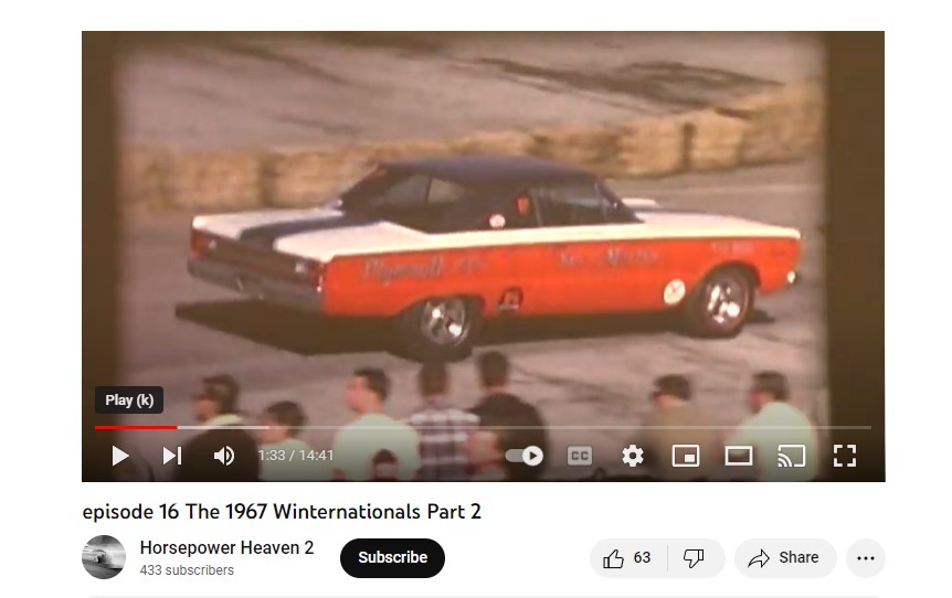

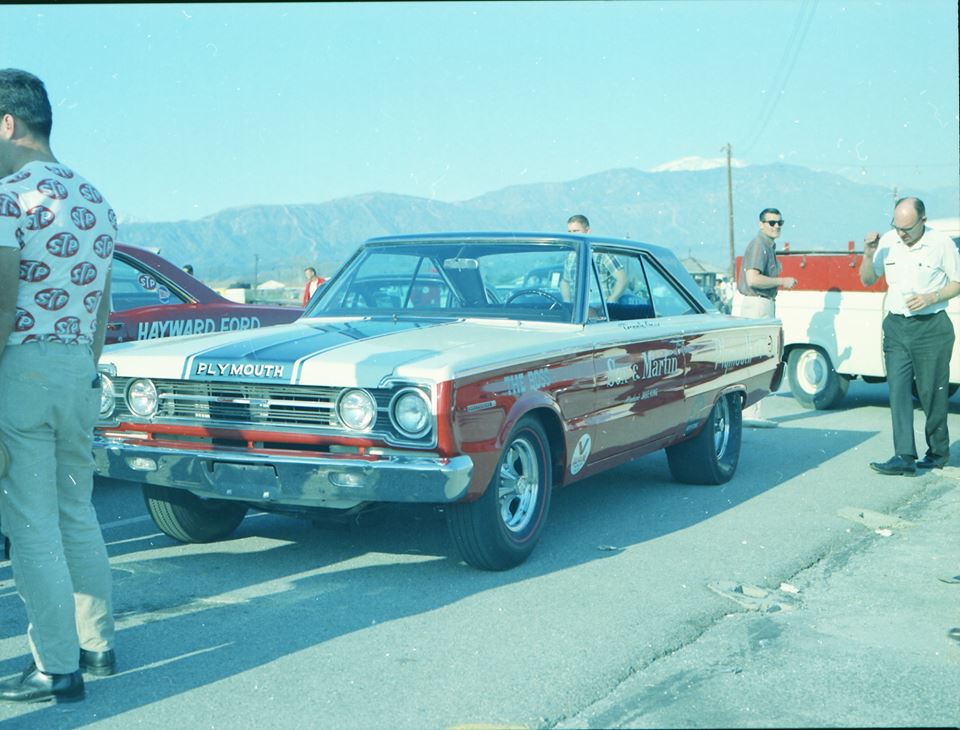

There is a widely syndicated picture of the S&M ‘cold air’ car at the 68 Winters running in SS/D. (Attached)
The ‘same’ O23’ type car was run in SS/C (68) by Rudy Schings and Wiley Cossey.....,so why was the Sox RO run in a slower class at both the 67 Winters (SS/C) and the 68 Winters (SS/D)?
My only conclusion is S&M ran an air cleaner...conning NHRA into thinking it was the same engine as a factory GTX - which of course it wasn’t. (Blueprinted, bigger carbs, modded intake)
I guess we’ll never know....but its a heck of a curve ball!

They didn't run the R0/W0 cars at the Winters, because they weren't built yet!!! The NHRA Winternationals were 2/5/1967. This is why the Belvedere ran in C at the Winternationals, and B the rest of 1967, AFTER they received the parts to convert it to R0 trim. Does it not click in your mind that NO ONE else was running an "R0" car at the Winternationals?
The dealer pricing info was sent out on 2/10. The sequence numbers were assigned on 2/12. There is generally a one month difference between the scheduled and actual build date. The earliest ship date for a '67 R0 Plymouth that I have documented is 3/23. The earliest '67 W0 Dodge date I have seen is 3/27. This is info coming right from Chrysler IBM build cards. I've been researching '67 R0/W0 cars for quite a while now.
If you go back to my comment, where you're trying to disprove me, I stated Sox & Martin only had two '67 HEMI cars. I know there was a third car. It was a 440 GTX, with white interior. We've been through this numerous times, in different places, but you can't keep or get your facts straight.

So how do you explain the cold air hood on the S&M car at the winters?
Happy to accept the 023cars were not ready...bur explain the scoop?
And what cars did Grotheer and Charbonneau run in SS/B at Pomona in 67? Because the flat hood GTX ran in SS/C
And how do you explain the S&M cold air scoop at the 68 Winters in SS/D, when the Cossey and Schings O23 cars ran in SS/C that year?

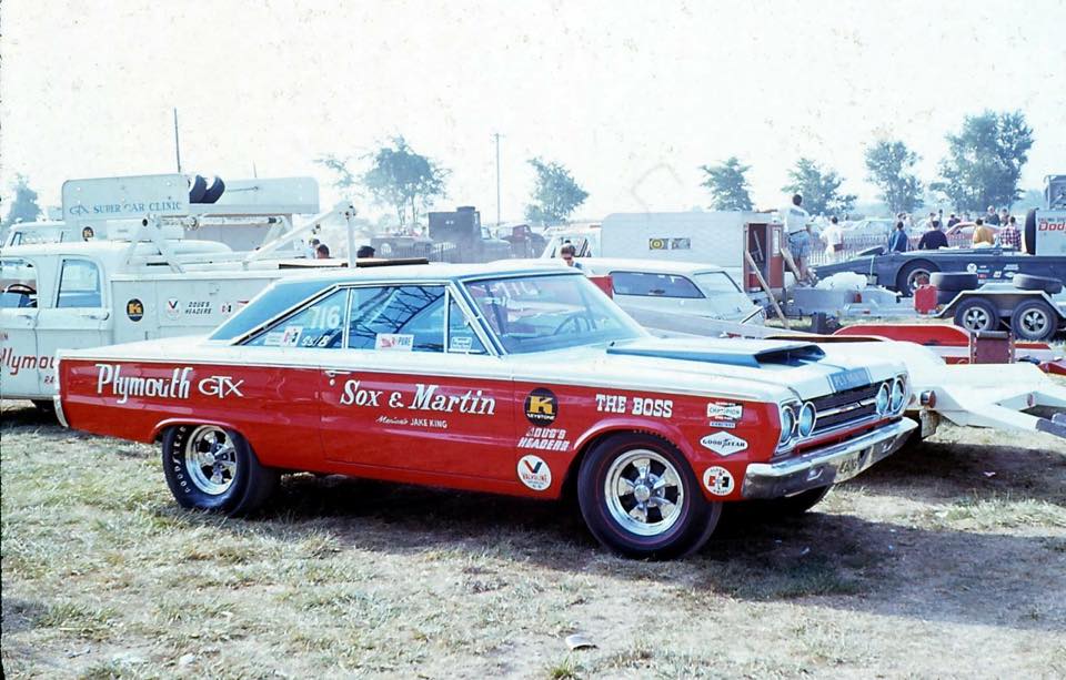

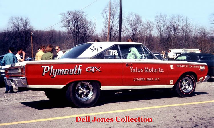

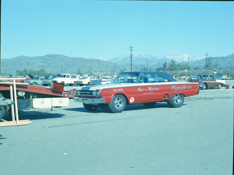

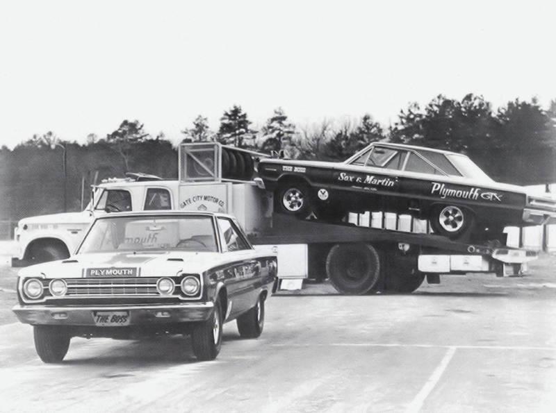

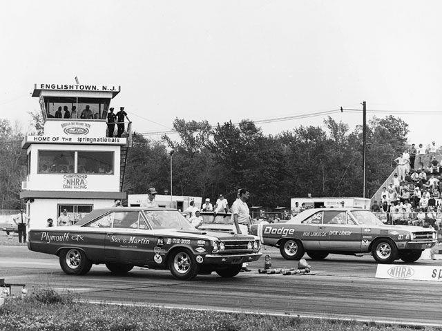

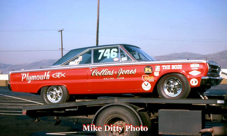

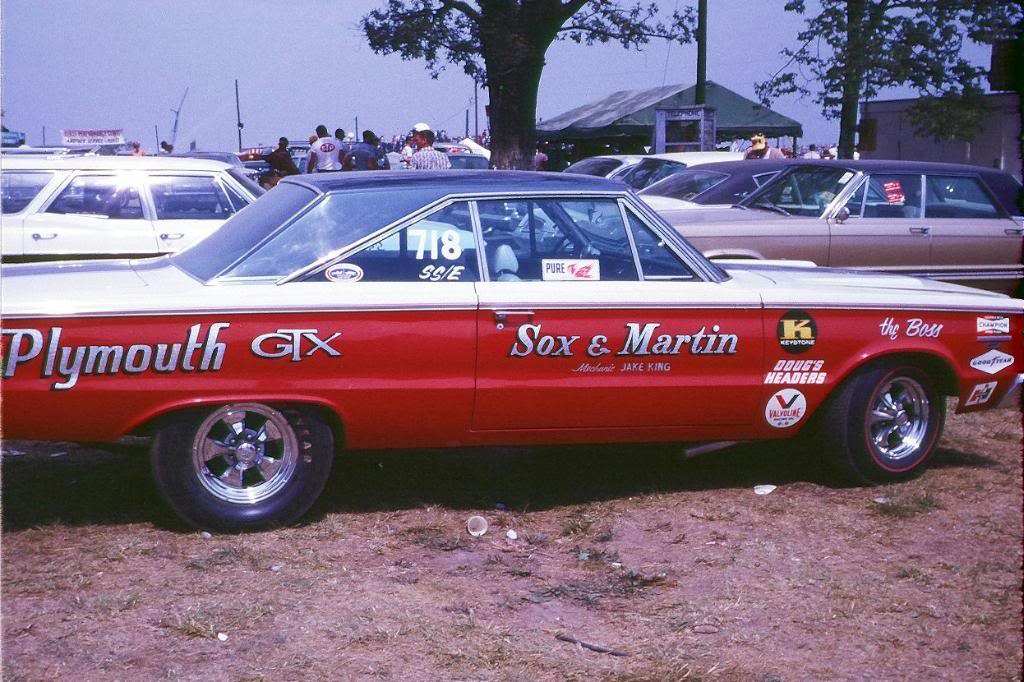

There is no scoop to explain before March of 1967. Sox had two cars at the start of '67...the flat hood Hemi Belvedere (383 car originally), and the twin scooped 440 GTX (white interior). The third car was the R023 which came later (May). There are plenty of early 1967 photos showing the first two cars with their old white hauler before they got the new R/W/B hauler later that year. Also, if you look at early photos of the white interior car...it did not have the Belvedere trim on it, that was added later.
The 383 car was kept through '68. After the R0 scoop came available, it was converted. They put a rectangular Hemi badge on the front edge of the fender where the Belvedere nameplate normally was. The R0 car always had both name plates on it (Belvedere & Hemi). This is all documentable by publicly available photos. The photos I attached are the converted 383 car.
Jim Skarbek wanted to buy Ronnie's '67 car, but Ronnie was contractually obligated by Chrysler to continue running it into 1968. Sox & Martin prepared Skarbek a B029 car instead. Sam Carroll bought the 440 car.
Charbonneau ran his '66 from the year before, he got a '67 Fairlane not long after. Grotheer also ran his '66. Grotheer never had an R0 car...his '67 car was built from a 6-cylinder car using the driveline from the '66 car he had.
The '68 explanation is the whole topic of this post. Chrysler submitted bogus paperwork and NHRA allowed the scooped hood on the '67 cars. If you ran in Belvedere or Coronet 440 trim, you ran C. If you ran as a GTX or Coronet R/T...you ran D. NHRA put a stop to this, and that's why Sox put the twin scooped hood on his car for Englishtown. Geoff Stunkard covered that years ago in one of his articles in the collector's guide.
The info is out there man, you've got to want it, and you're not going to find the answers in anything written by Larry Davis or Jim Schild.

The 440 car...note how the Belvedere trim was added later.
