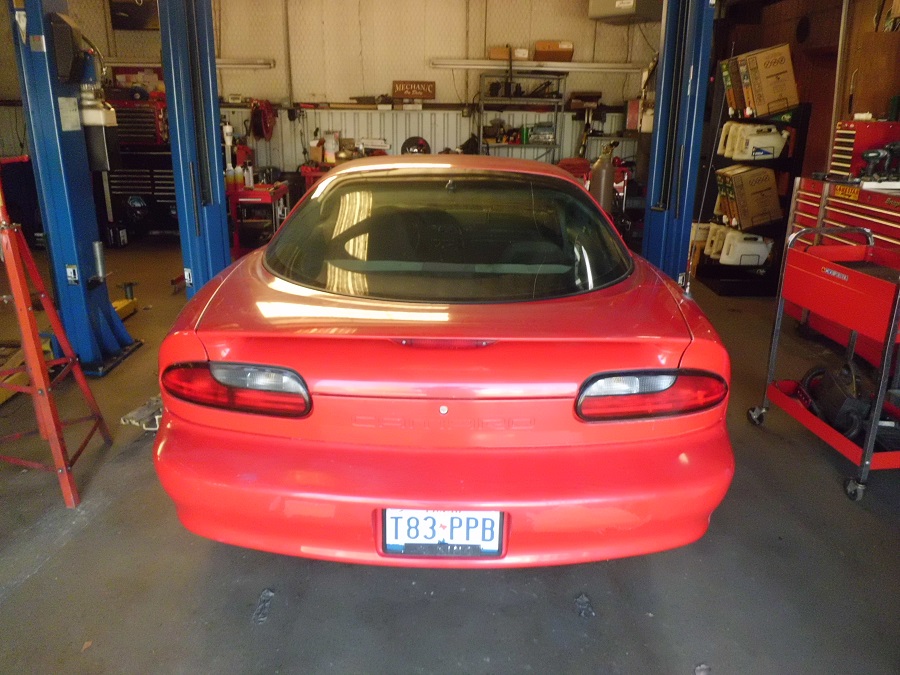

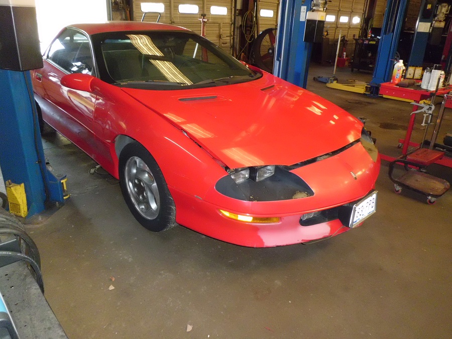

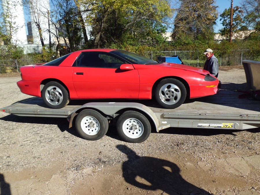

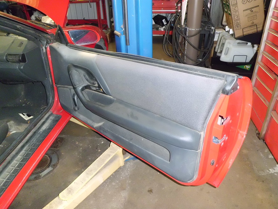

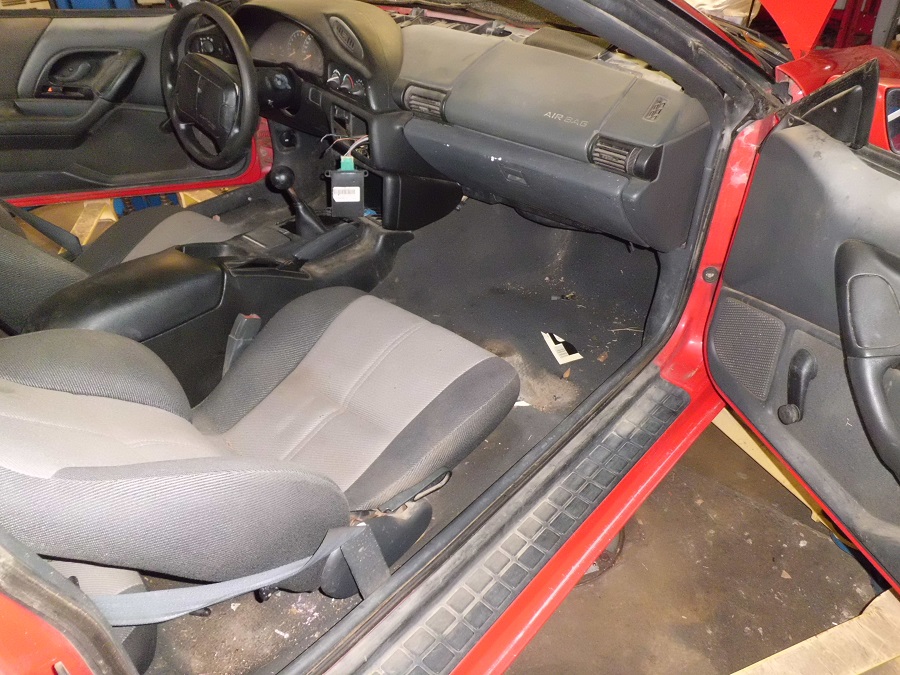

Here is the "core" car, 1995 Camaro for $700.00
ID:	31722   Click image for larger version
ID:	31723   Click image for larger version
ID:	31725   Click image for larger version

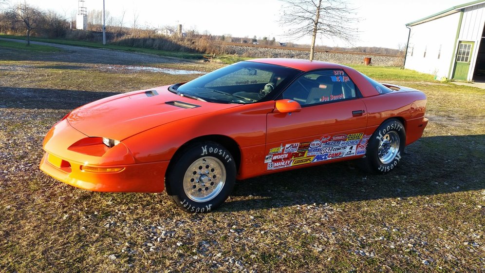

I just finished a 95 myself but didn't get a chance to get it out before the season ended up here. This was the first car I built that I didn't have much fun doing. It was a real PITA. Can't wait to see how it turns out!

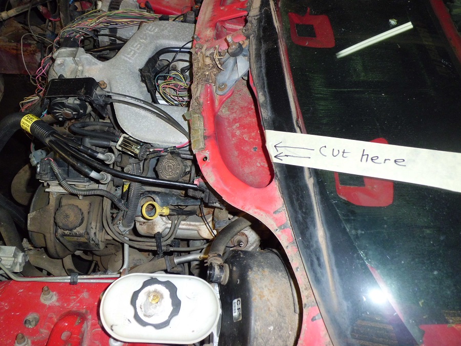

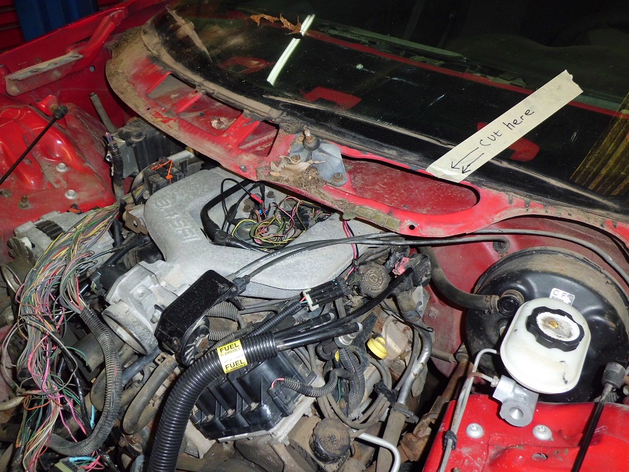

I like the appearance of this 95 Camaro and the "newer" bodies are easier to find in good condition. Plus, the pricing for a core car is very reasonable. In addition, the engine set back and 101" wheel base makes for excellent drag weight bias. Plus they have a good aero shape.
Yet, even with all those advantages I fretted and fretted over the poor access at the rear of the engine. Some for you may have experienced this same fretting with other situations.
I have good news! It is a big advantage to build a dedicated, trailered race car because the street equipment is no longer and issue. Some creative "carving" around the wiper linkage and cowl area will be a big help with engine access.
This photos shows the V/6 still in place and you can get an idea of what it will look like with the cowl trimmed back to the windshield. Then under the windshield trimmed back to the firewall.
Stand by for more.

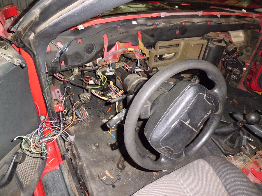

I was just watching a piece on Nova about Einstein's theory of general relativity. During his lifetime he conceived mathematical formulas that describe the relationship between, time, space, light and gravity.
You are hearing it here first, I now present a formula that describes the relationship between tearing down a "core" car and rebuilding it to a finished package.
The formula is [HT x IH + M = C] {Hours Teardown x Infinite Hours + Money = Completion}
Today one of my mechanics, Flash, took a few mins to remove the dash. Although I warned him to be careful, I think he has cut the racing wire. Theory indicates that the racing wire is necessary to bend time.

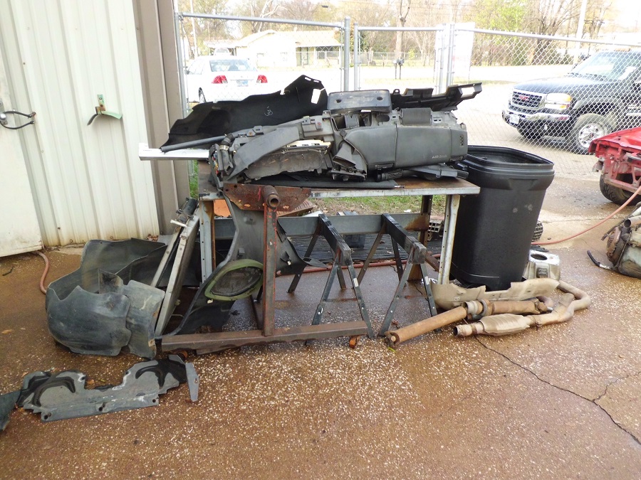

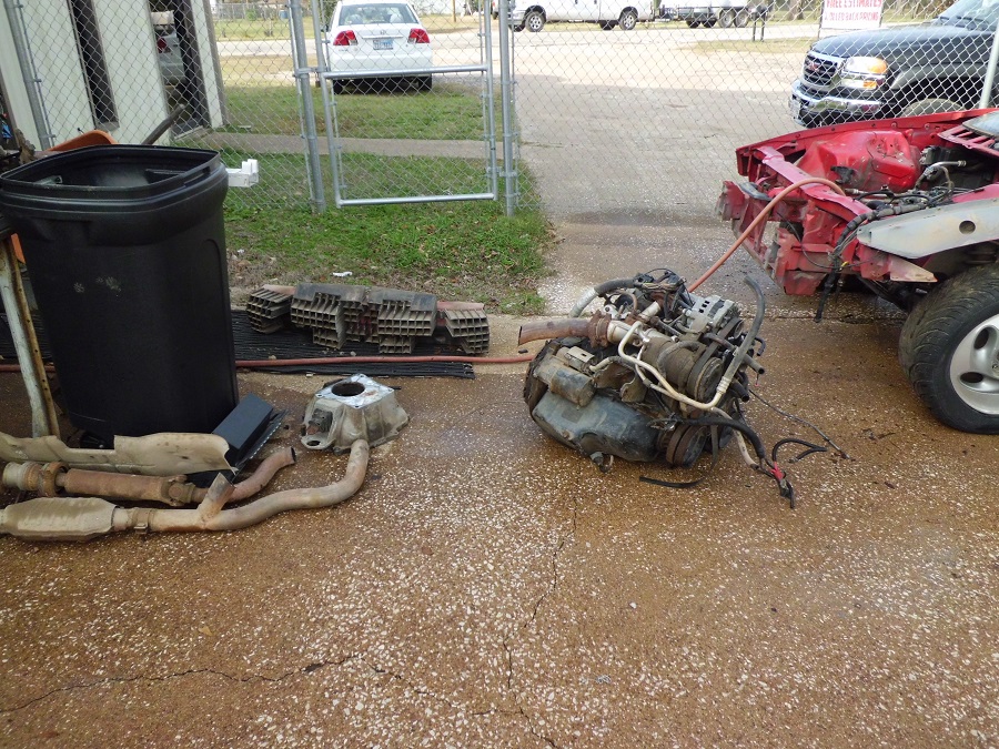

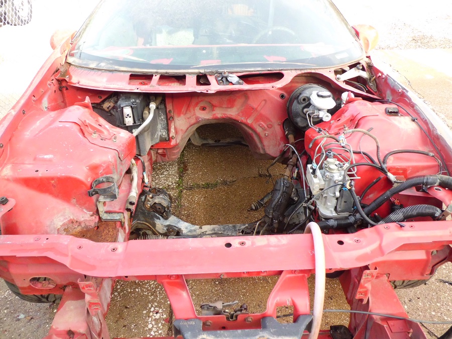

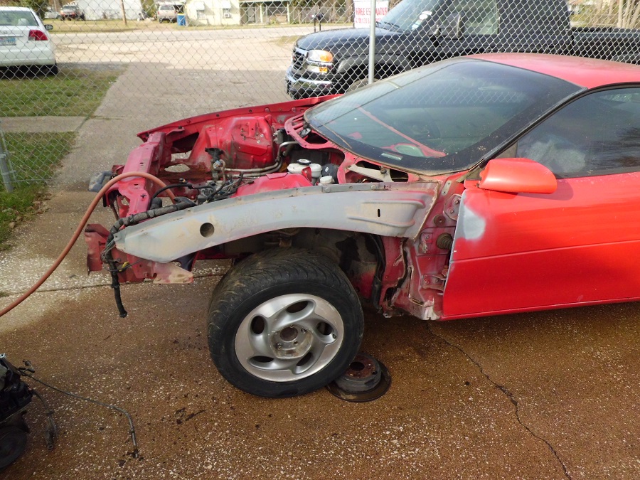

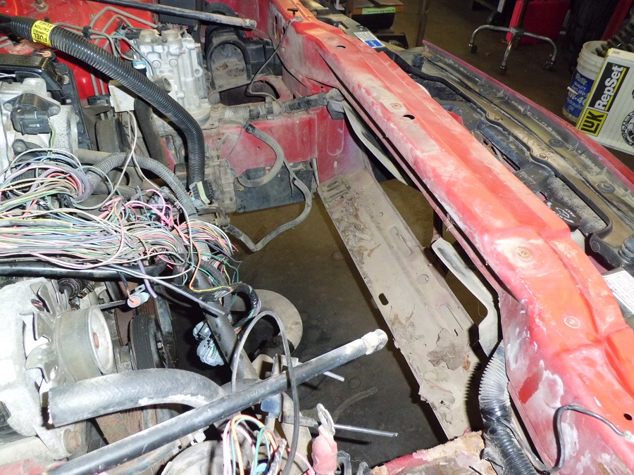

Progress report;
The first stage of tear down is completed. At this point I can visualize the completed package and for a while this build will be simmering on the back burner while other project take my time.
I now understand that the 4th gen is an excellent package and I look forward to it's construction and racing.
