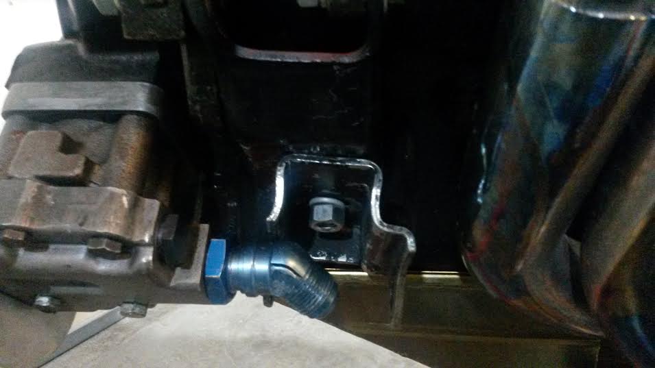

Hey all..I went and done it and stepped up to a bigger motor. It has dual line external oil pickup. I'm new to this. I'm looking at the motor and where it sits, it looks like where the oil pump cover where the fitting comes out, is gonna hit the motor mount spot on the k frame. Im hoping to do this without buying a differnt oil pump cover if at all possible. This is on a 69 b-body. any help is greatly appreciated and if its in the wrong section i apologize.
Thanks!

Well I need too figure out how to get my pictures up and show what I have. .theres no way it's gonna sit in there how the fitting comes out of the oil pump

testing seeing how this if i got this to size to work...no i problaby dont need a dual system but it came with the motor that i bought

Milodon has two covers that the oil line goes in straight instead from the back. One is for remote filters and one has the oil filter base built in.
http://www.manciniracing.com/mibiwealoilp.html

I have had several 65-68 cars with that system. It doesn't look like it will work but it does. When you get thru torching the stock motor bracket to fit the lines there's not much left of it. But that's how people did it in the 70's and 80's. They also used a torque strap to catch the motor in case the motor mount failed.
