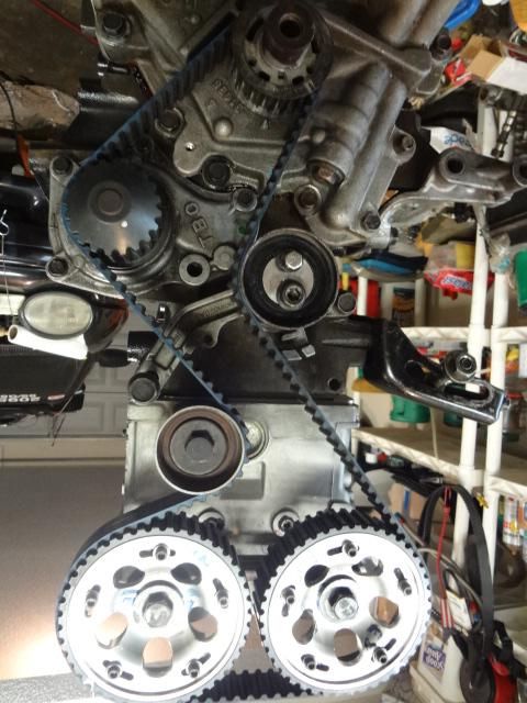

Here's a pic of the front of the motor.
Art Leong 2095 SS
